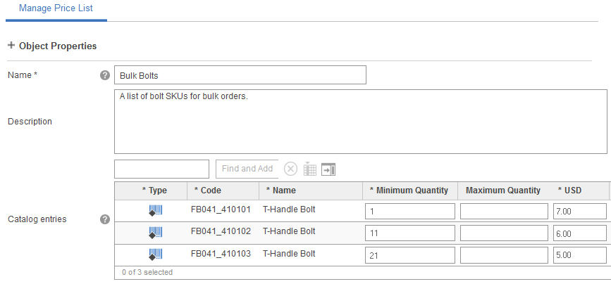

Range pricing is typically used to offer customers a lower price per catalog entry if they purchase a larger quantity of the catalog entry. To specify range pricing, a price list must contain multiple entries for each catalog entry. For each entry, you must specify a minimum quantity and an associated price.
The following is an example of a price list viewed in Lab containing range pricing for the T-Handle Bolt catalog entry:
Range pricing in a price list
In this example:
  • If the customer purchases 5 packages of T-Handle Bolts, the price is 5 x $7.00 = $35.00
  • If the customer purchases 100 packages of T-Handle Bolts, the price is 100 x $5.00 = $500.00

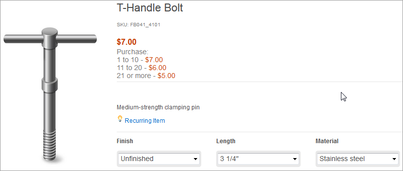

If you use range pricing in your price lists, the ranges are displayed on the product details pages of the store:
Range pricing on the product display page
