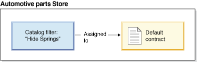

To achieve this goal, the sales manager creates a catalog filter called
When customers view the automotive parts store, they cannot see the Springs category.
Hide Springsand assigns it to the store default contract as shown in the following diagram:
