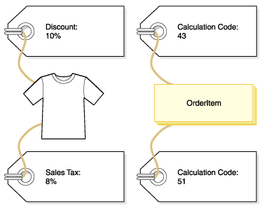

Items for sale in a retail store often have attached price tags indicating information other than the price of the item. For example, if the item is on sale, the price tag indicates the percentage discount to apply to the price. Similarly, HCL Commerce attaches calculation codes to order items to indicate the calculations to be performed.
Calculation codes indicate the calculations that must be performed
The following figure shows a representation of price tags in a retail store compared with calculation codes in HCL Commerce.
In the same way price tags are attached to the items for sale in a retail store, calculation codes are considered to be attached to order items. The attachment of a calculation code can be direct or indirect, depending on where the calculation code is specified within HCL Commerce.
