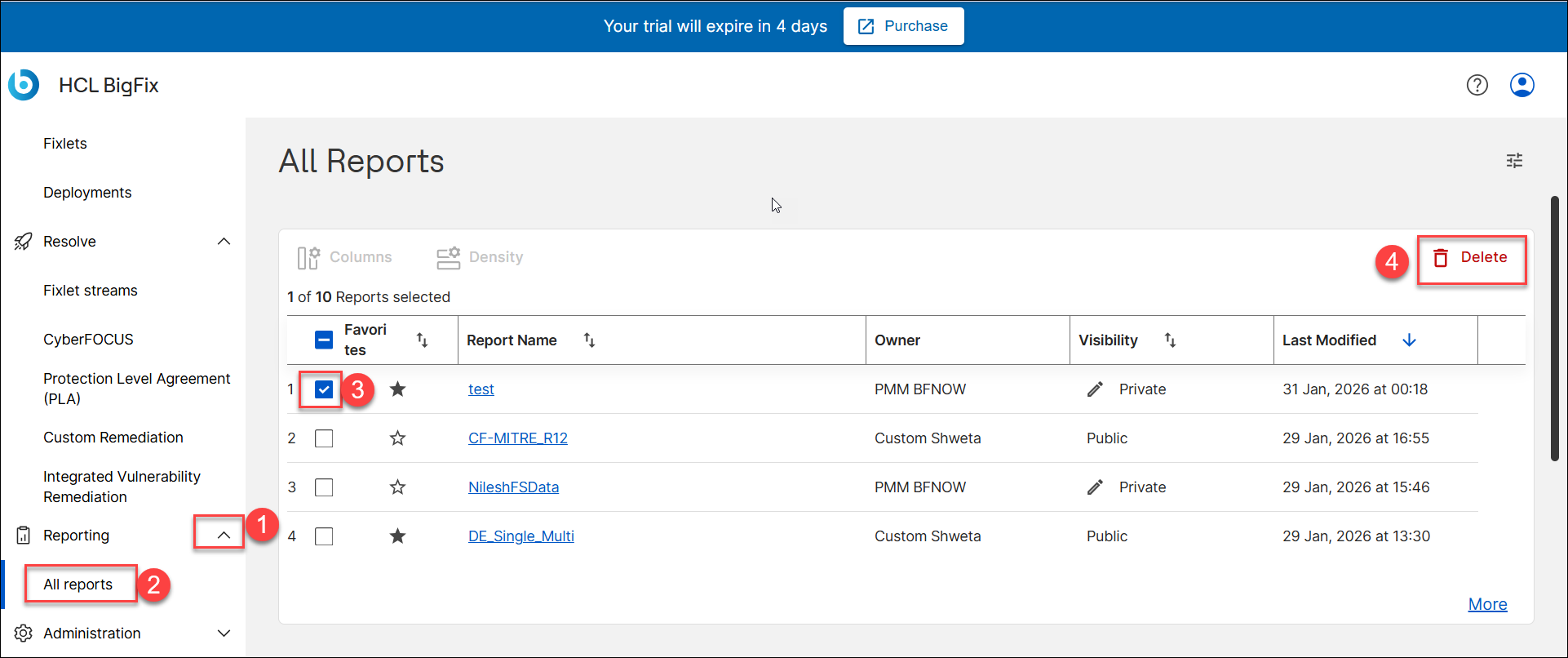

Access a saved report
Saved reports are available across sessions, allowing users to load them whenever needed without reapplying the same filters and sorting each time.
  1. To load a saved view, expand Reporting and click All reports.
Delete a report
To remove a saved report:
  1. From the All Reports page, select a report you wish to delete, then click the delete icon on the top right corner.
  2. Confirm the action when prompted.
This permanently removes the selected view from your saved views, and it will no longer be available for future use. This action helps keep your saved views organized by removing outdated or unnecessary configurations.

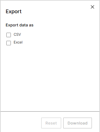

Exporting Data
The Export Data option is available on Deployments, CyberFOCUS, All reports, and list view pages of Devices, Fixlets. Use this option to download tabular report information from list view pages for offline analysis or record-keeping.
It enables users to export visible report data—filtered, sorted, or customized to commonly used spreadsheet formats like CSV or Excel.
This allows users to review device inventories, fixlet compliance, or deployment summaries outside the BigFix UI environment.

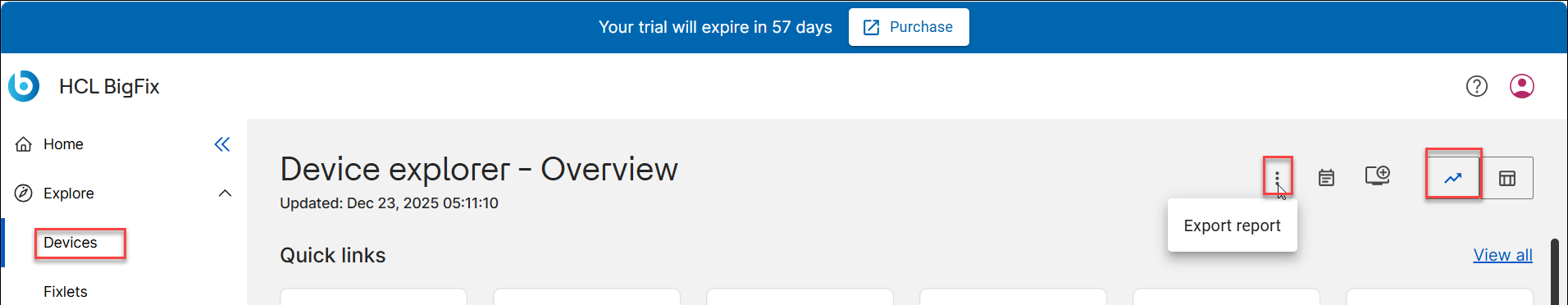

How to Export Data:
  1. Click the Export Report icon located in the upper-right corner of the page.
    The Export panel slides out and displayed.
  2. In the Export panel that appears:
    • Select CSV to export raw comma-separated data for importing into other tools.
    • Select Excel to export data into a formatted spreadsheet (.xlsx) file.
  3. Choose Data to Export: Depending on the module and screen you are in, you have the option to export the entire dataset visible on the screen or apply filters to export a specific subset of data.
    • If applicable, apply filters or selections within the module to export only the necessary data, reducing file size and focusing on relevant information.
    • Depending on your user role and permissions, access to certain data subsets may be restricted.
  4. After selecting the desired format, click Download. The file gets generated and downloaded to your device.
  5. (Optional) Click Reset to clear all selections before downloading again.

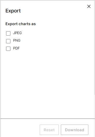

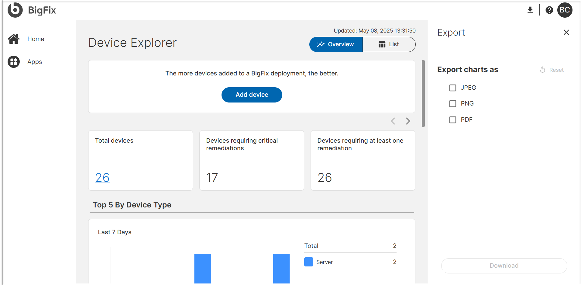

Exporting Charts
The Export charts option is available on CyberFOCUS and Overview pages of Devices, Fixlets. Use this feature to capture dashboard visualizations from overview pages as image or document files for reporting and presentation purposes. It allows users to download graphical widgets such as bar charts, donut charts, or summary tiles that visualize system compliance, device types, or OS distribution trends.
Charts can be exported as JPEG, PNG, or PDF files, making it easy to include BigFix data visuals in internal reports or external presentations.
How to Export Charts
  2. In the Export panel, select one or more of the following options:
    • JPEG – Exports charts as compressed images suitable for quick sharing.
    • PNG – Exports charts in higher resolution for professional documentation.
    • PDF – Consolidates all visible charts into a single report document.
  4. Confirm and Download: After selecting the desired format click Download. The file gets generated and downloaded to your device.
    If you have choosen more than one format to export, the files will be downloaded in a single zip folder.
  5. (Optional) Use Reset to deselect all options before making a new export.
