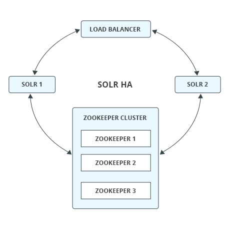

SOLR Installation – High Availability (HA) Mode
This section describes the procedure for installation of Solr in HA mode which is integrated with Zookeeper. This is applicable only for Windows Sever.
For Apache Solr in H.A, configure Zookeeper on at least three different servers because for ZooKeeper cluster to be active, there must be a majority of non-failing machines that can communicate with each other. For this reason, ZooKeeper cluster is usually made up of an odd number of machines. It runs as an ensemble of ZooKeeper servers i.e., Zookeeper cluster. User must integrate Zookeeper cluster with two Solr node running on different servers that are connected with Load Balancer.
Minimum configuration for each of the servers are explained below:
  • Windows Server 2016 with 64-bit Processor
  • 2 GB of RAM, and 80GB HDD hard drives
  • 2 Cores
Figure 1. Figure 76 - Installation of Solr in HA – Architecture

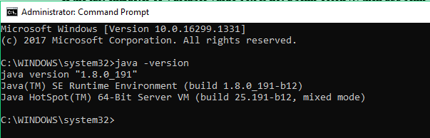

    1. Ensure that Java version 1.8 or higher is configured in the system and JAVA_HOME variable is set. To check the same, open the Command Prompt and type the below command:
    Java -version
    Figure 2. Figure 77 - Installation of ZooKeeper
    1. Proceed with the installation if the Java version is displayed. If not, please install Java as mentioned in section Java.

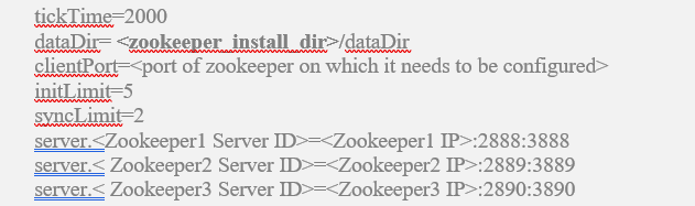

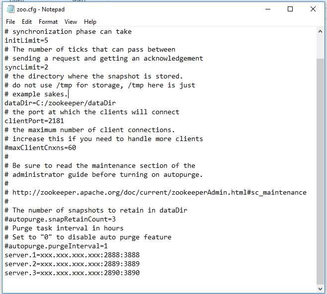

    1. Go to <zookeeper_install_dir>/conf folder and open zoo.cfg file. Change the below parameters and add details of three zookeeper servers. Here you need to select three distinct zookeeper ids for three distinct servers. (Keep it numeric).
    Figure 3. Figure 78 - Installation of ZooKeeper (cont.)
    1. Enter the same parameter details in zoo.cfg file.
    Figure 4. Figure 79 - Installation of Zookeeper (cont.)
  2. For Reference, zookeeper will use these ports (2888, 2889,….) to connect the individual follower nodes to the leader nodes. The other ports (3888, 3889,….) are used for leader election in the ensemble. Make sure all these ports must be different from each other.

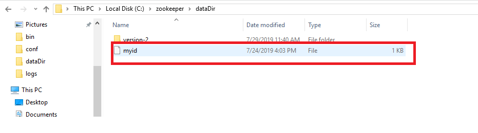

    1. Go to <zookeeper_install_dir> and open Command Prompt as Administrator and type the below command:
    (echo<Zookeeper Server ID>)>dataDir/myid
  3. e.g. – (echo 1)>dataDir/myid
  4. This command will create a file inside dataDir folder with name myid and add the server ID. The server ID is a number between 1-255, and it must be unique. Also it must correspond with server.${id} in the zoo.cfg files.
Figure 5. Figure 80 - Installation of Zookeeper (cont.)
  1. In above example followed, there are 3 server IDs 1, 2 and 3. So, for the respective server, it’s zoo.cfg should contain its respective id.

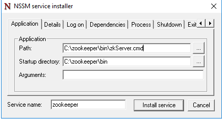

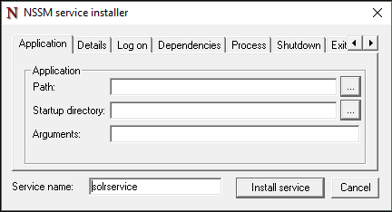

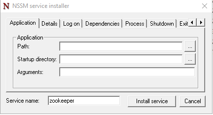

  1. The below window will be displayed.
Figure 6. Figure 81 - Enabling Zookeeper as Windows Service
  1. Click Application tab and enter the information as mentioned below:
Path: <zookeeper_install_dir> \bin\zkServer.cmd
Startup Directory: <zookeeper_install_dir> \bin
Figure 7. Figure 82 - Enabling Zookeeper as Windows Service (cont.)

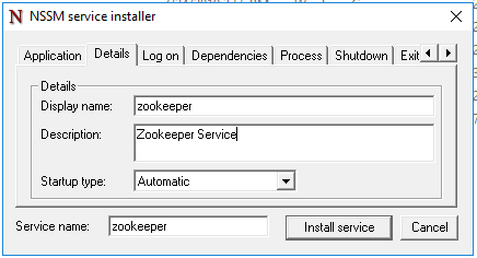

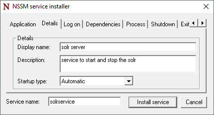

  1. Click Details tab and enter the information as displayed in the image below:
Figure 8. Figure 83 - Enabling Zookeeper as Windows Service (cont.)

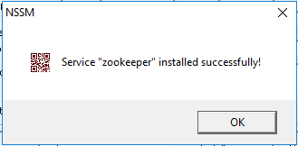

  1. Click Install Service.
  2. Upon successful installation, following message will appear.
Figure 9. Figure 84 - Enabling Zookeeper as Windows Service (cont.)

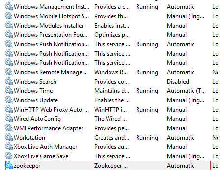

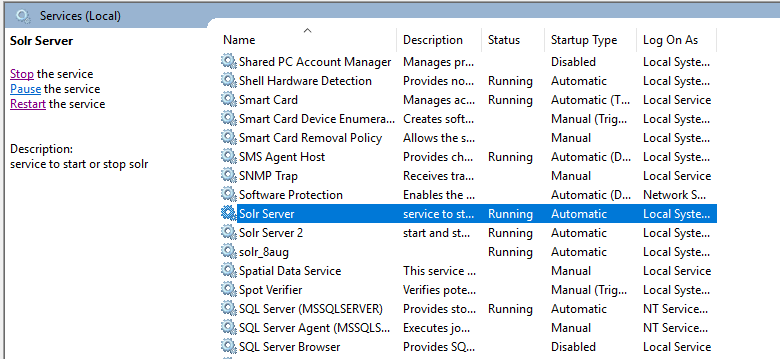

  1. Press Win+R, type services.msc and press OK.
Figure 10. Figure 85 - Enabling Zookeeper as Windows Service (cont.)
  1. Search for zookeeper service and click on zookeeper service.
  2. Click Start the service on the left panel to start the service.

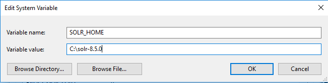

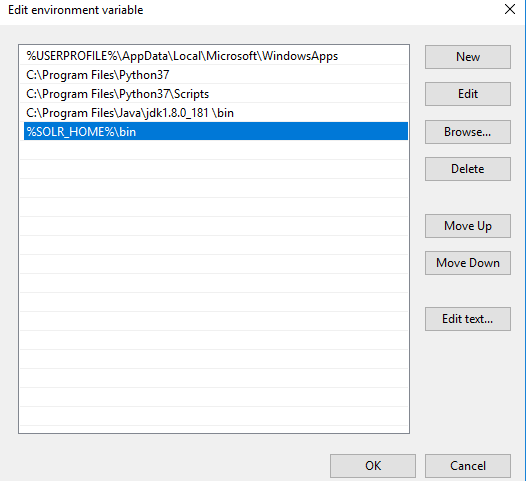

  2. Set SOLR_HOME environment variable and add to PATH environment variable. Follow the below steps to set the SOLR_HOME and PATH.
  1. Go to Control Panel System and Security Advanced System Settings.
  2. Click Environment Variables. A new dialog box appears.
Figure 12. Figure 87 - Installation of SOLR
  1. Select Path in System Variables and add the respective path of Solr mentioned above.
  2. Set the environment variable as depicted in the image above.
  3. Add %SOLR_HOME%\bin to PATH environment variable.

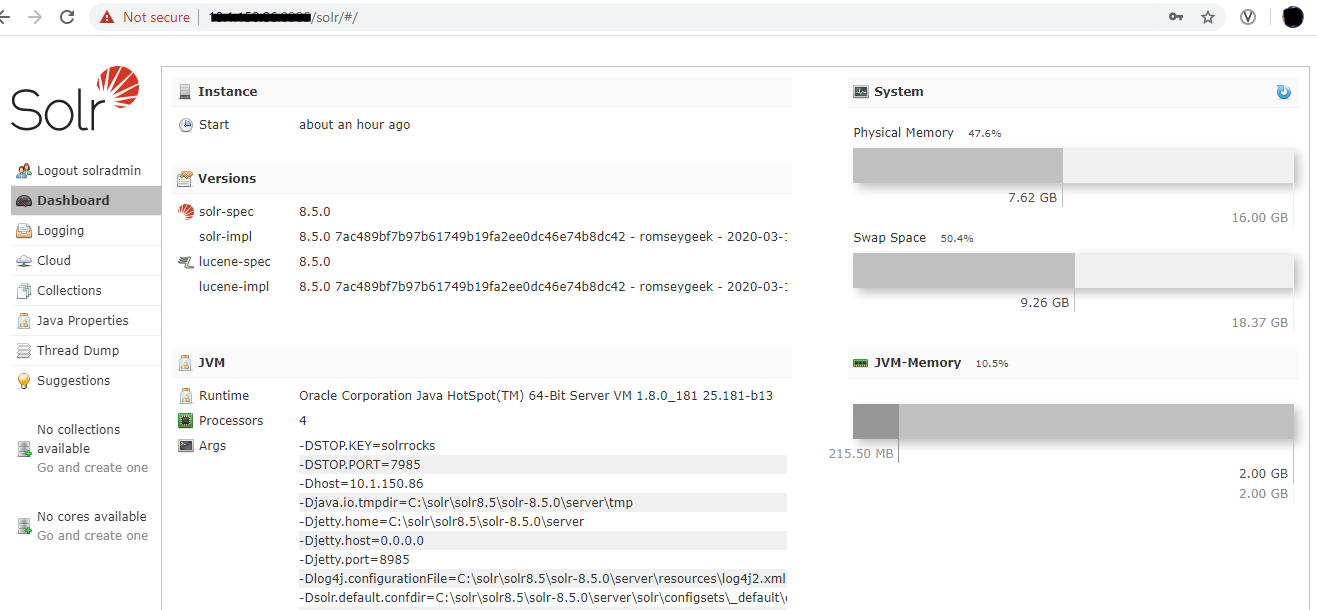

    1. Execute the below command in browser to ensure that Solr is running with authentication and authorization enabled.
    http://<IP>:<SOLRPORT>/solr/admin/authentication
    http://<IP>:<SOLRPORT>/solr/admin/authorization
    1. Enter the username ‘solr’ and password ‘SolrRocks’ when prompted for authentication.
  1. If the message “authorization.enabled”:true is displayed, it confirms that authorization has been enabled successfully.

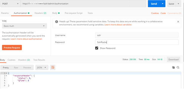

    1. Execute the below command as POST request on any of rest clients such as Postman or Curl. Select Basic Authentication and provide Username and Password as created in above steps under authorization tab. This creates a new user with UserName to be further used as <user_name> in credentials.
    URL: .
  2. In Basic Authentication use the below credentials.
    Username: solr
    Password: SolrRocks
    In the Body tab, select input as Raw JSON (application/json) and provide the below input.
    "set-user": {"<user-name>" : "<password>" }
    e.g. –
    This will create user with username: solradmin and password: Admin098
    "set-user": {"solradmin" : "Admin098" }
    Now, a Solr user has been created with UserName as ‘solradmin’ and Password as ‘Admin098’.

    1. Click Details tab and enter the below information:
    Figure 17. Figure 92 - Enabling Solr as Windows Service (cont.)
    Figure 18. Figure 93 - Enabling Solr as Windows Service (cont.)

    1. Check the below mentioned URL in browser:
  1. http://<SOLR IP>:<SOLRPORT>/solr
  1. Enter username as “solradmin” and password as “Admin098” on Solr Portal Login Page.
Figure 21. Figure 96 - Enabling Solr as Windows Service (cont.)

  1. Ensure that Java version 1.8 or higher is configured in the system and JAVA_HOME variable is set. To check the same, open the Command Prompt as Administrator and type the below command:
java -version
  1. Proceed with the installation if the Java version is displayed. If not, please install Java as mentioned in Java.
  1. Go to Control PanelSystem and SecurityAdvanced System Settings.
  3. Select Path in the System Variables and add the respective path of Solr mentioned above.
Figure 23. Figure 98 - Installation of SOLR without HA
  1. Set the environment variable as depicted in the image above.
  2. Add %SOLR_HOME%\bin to PATH environment variable.
Figure 24. Figure 99- Installation of SOLR without HA (Cont.)

    1. Execute the below command as POST request in any of rest client such as Postman or Curl and Select Basic Authentication with Username as solr and Password as SolrRocks under Authorization tab and set the user role using Post request with the URL specified below:
  1. This step will provide admin rights to user which will is mentioned in <username> tab.
    1. Enter the respective IP and Solr Port.
    2. In the Body tab, select input as raw JSON (application/json) and provide the below input.
    { "set-user-role": {"<user-name>":["admin"]}}
  2. e.g. – This will provide admin rights to solradmin
    { "set-user-role": {"solradmin":["admin"]}}

  2. Go to the SOLR_HOME\bin. Open the Command Prompt as Administrator.
  3. Execute the below command:
nssm install solrservice
  1. The window shown in below image appears.
Figure 26. Figure 101 - Enabling Solr as Windows Service

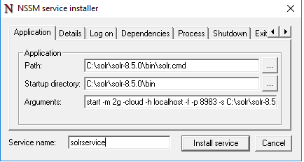

Path: C:\solr\solr-8.5.0\bin\solr.cmd
Startup Directory: C:\solr-8.5.0\bin
Arguments: <Enter values as mentioned below>
start -m 2g -cloud -h <SOLR_IP> -f -p <SOLR_PORT> -s <SOLR_HOME\server\solr>
e.g.
start -m 2g -cloud -h localhost -f -p 8983 -s C:\solr\solr-8.5.0\server\solr
Figure 27. Figure 102 - Enabling Solr as Windows Service (cont.)
  1. Click the Details tab and enter the information as displayed in the below image:
Figure 28. Figure 103 - Enabling Solr as Windows Service (cont.)
  1. Click Install service.

  1. Press Win+R, type services.msc and press Enter.
Figure 30. Figure 105 - Enabling Solr as Windows Service (cont.)
  1. Search for Solr Server service and click on it.
Figure 31. Figure 106 - Enabling Solr as Windows Service (cont.)

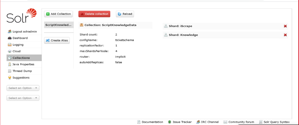

  1. Create collection named as ‘ScriptKnowledgeData’ in Solr for Basic Knowledge and iScrape using the below url:
http://<SOLR_IP>:<SOLR_PORT>/solr/admin/collections?action=CREATE&name=ScriptKnowledgeData&router.name=implicit&shards=iScrape,Knowledge&replicationFactor=1&maxShardsPerNode=4&collection.configName=ticketschema&router.field=shardType
  1. On successful creation of the collection, the following response is received:
