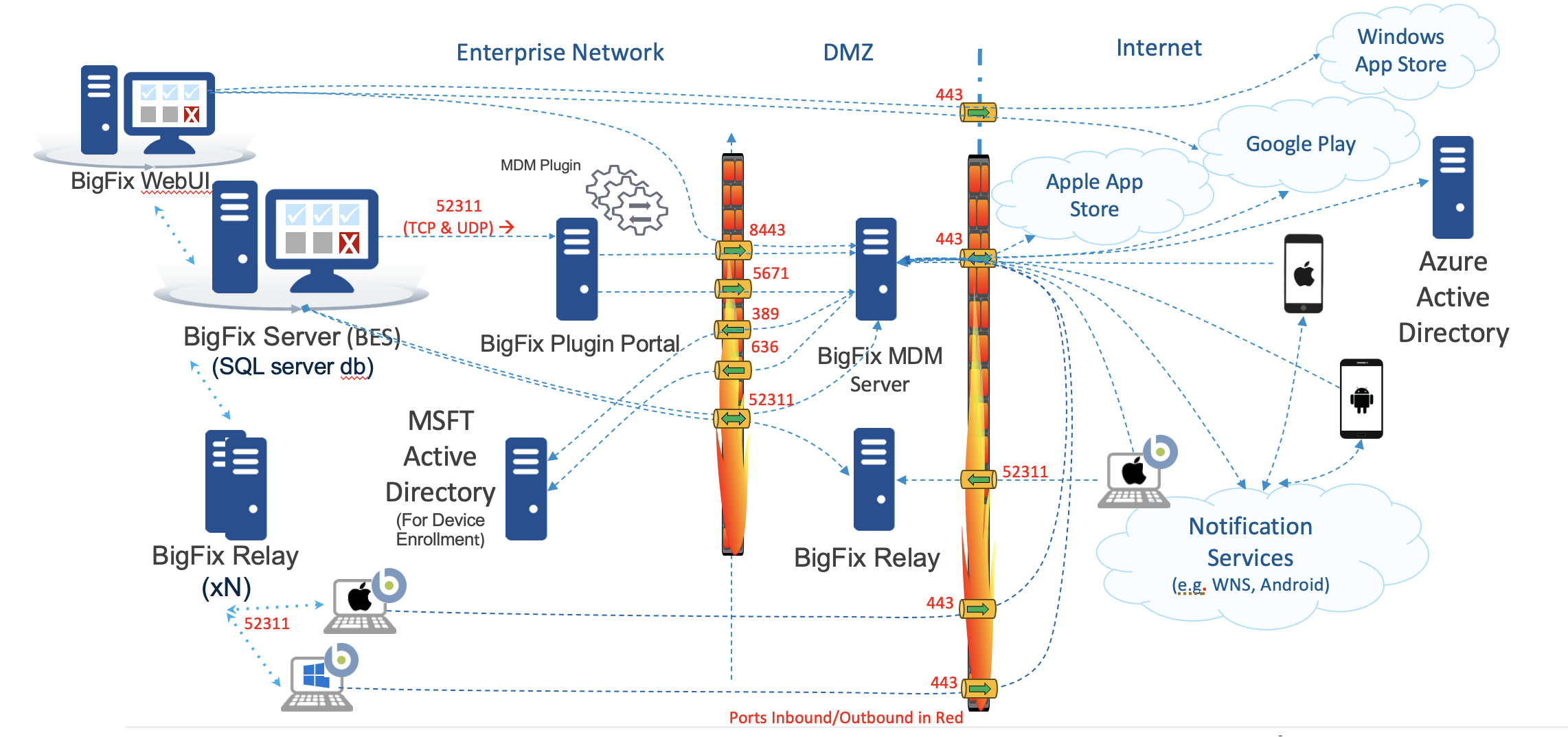

Firewall port requirements
For BigFix MDM Server and BigFix PlugIn Portal to communicate effectively with managed devices, it is essential to configure the necessary TCP/IP ports. This section outlines the required ports for efficient device management.
Proper firewall configuration is crucial for BigFix Modern Client Management (MCM) and BigFix Mobile, as it regulates secure communication among the MDM server, enrolled devices (Windows, Android, iOS), and external services (e.g., Microsoft, Google, Apple). Firewalls control traffic through specific ports, ensuring that only authorized communication occurs, thus safeguarding the environment from external threats and maintaining reliable connectivity between all components.
Port Requirements & Traffic Flow
BigFix MCM – On prem deployment
Port Flows with LDAP servers for MDM With Internet Connectivity
MCM firewall port requirements
Port Number Type Purpose Direction
443 HTTPS
All device enrollment and management requests are sent to this port. This must be an internet-facing port for the endpoints to reach the enrollment server.
Inbound to the MDM Server from the network where MDM managed endpoints are located.
443 HTTPS MDM Server to Offline Domain Join Server Inbound to the Offline Domain Join Server specifically for requests from the MDM Server
443 HTTPS For sending messages from MDM Server to notification services and identity service.
