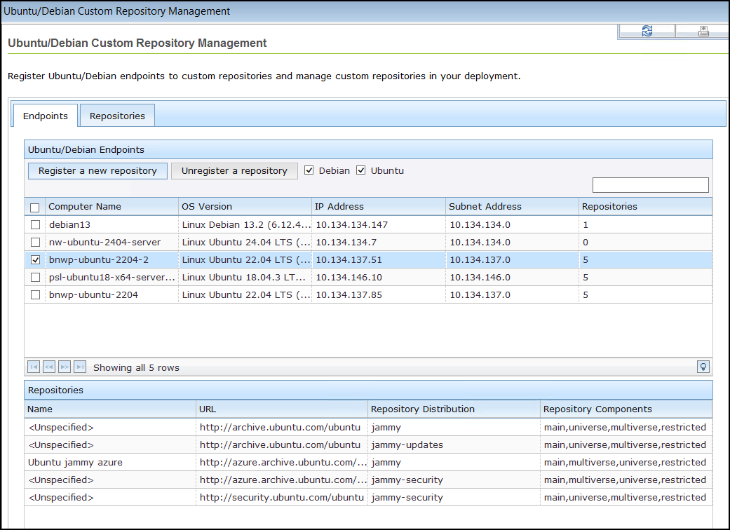

  1. From the All Content domain, go to Sites > External Sites > Patching Support > Dashboards > Ubuntu Custom Repository Management.
  2. From the Endpoints tab, select the endpoint on which you want to register a repository.
  3. Click Register a new repository. The repositories of the selected endpoints are listed in the lower part of the window. When a repository is named as unspecified, it means that it is not listed in the Repository list.

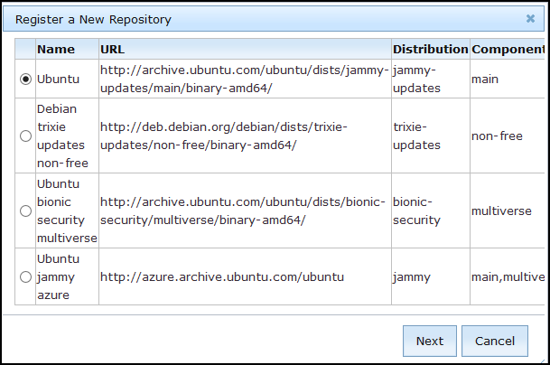

  4. From the Register a New Repository window, select the repository then click Next.

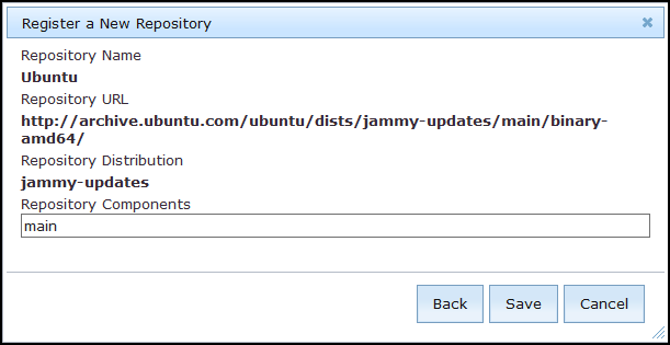

  5. The next window shows the name, URL, and distribution of the repository that you are registering. Enter the repository components. Use spaces to separate multiple components. You can also place additional fields.
  6. Click Save.
