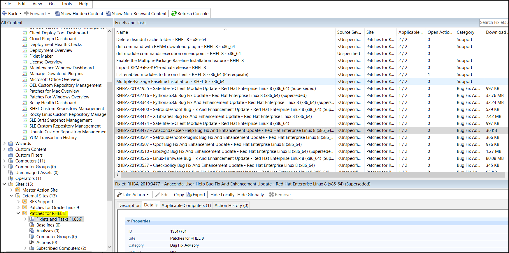

  1. In the console navigation tree, go to Dashboard→ License Overview.
  2. Enable the Patches for RHEL 8 site as shown below.
    Figure 1. License overview
    License overview
  3. Once enabled, the site will appear under External Sites, listing the available Fixlets.
    Figure 2. External sites - Fixlets

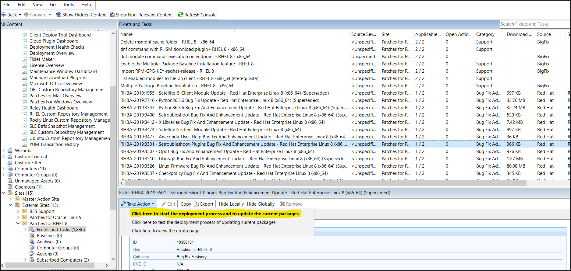

  4. To deploy the Fixlets, select the applicable Fixlet.
  5. Click Take Action and choose Click here to start the deployment process and update the current packages to deploy the Fixlet on the target endpoint.
    Figure 3. Click here to start the deployment process and update the current packages

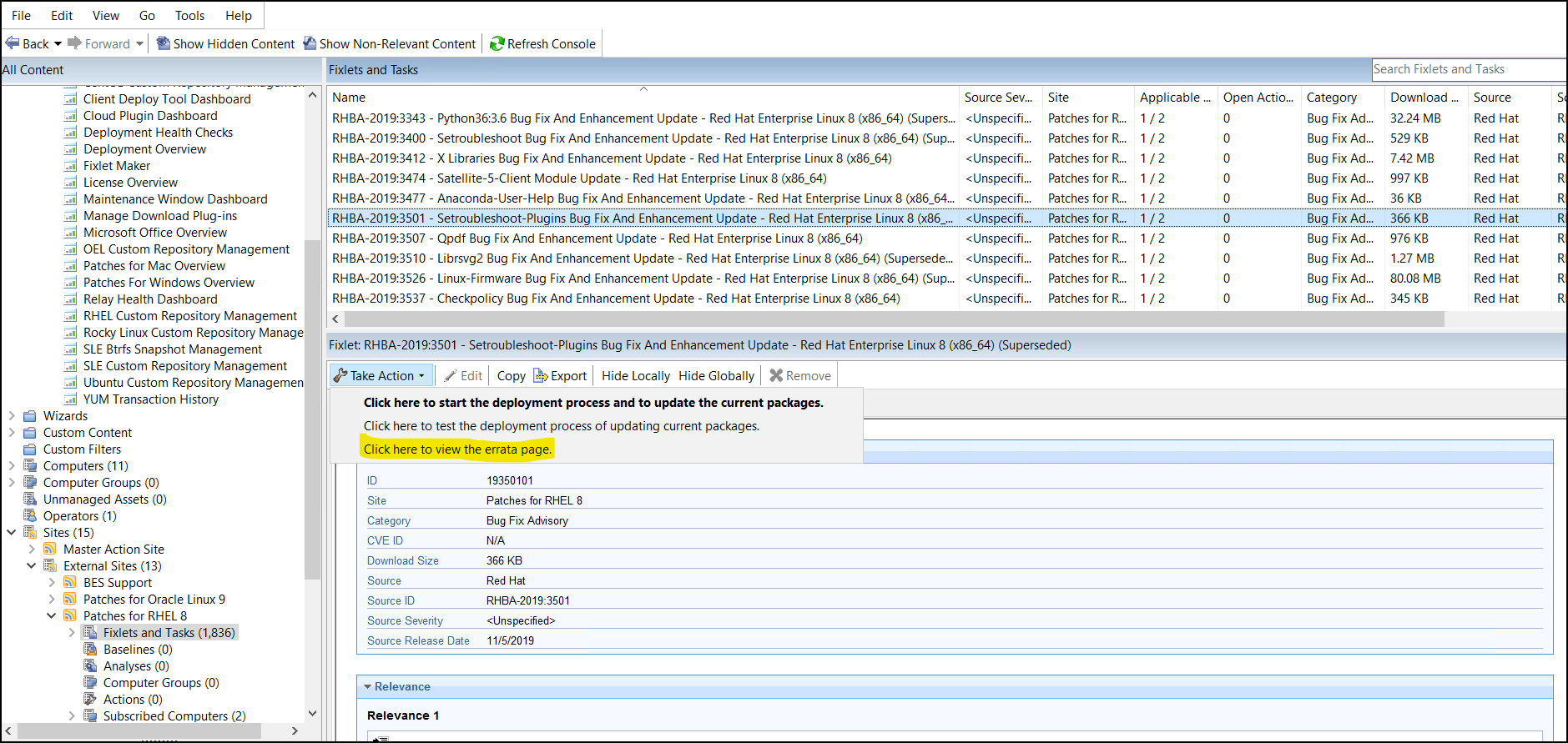

  6. To view the Red Hat Errata page for a particular Fixlet, Click Take Action and select Click here to view the errata page as shown below.
    Figure 4. Errata page
