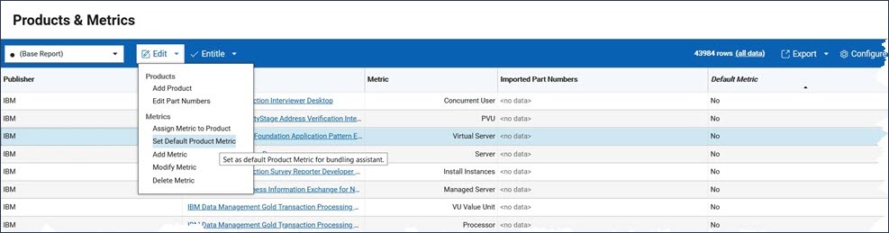

With the new capabilities, you can perform the following tasks:
- Add Metric
- Click this option to create a new custom metric. Select the code name and the display name and click OK. The metric is added.
- Modify Metric
- Click this option to modify a display name of a custom metric. Select
the code name: display name and the display name and click OK. The metric
is modified.Note: You cannot modify a non-custom metric. Only custom metrics are listed.
- Delete Metric
- Click this option to delete a custom metric. Select the code name: display name and the display name and click OK. The metric
is modified. Note: You cannot delete a custom or non-custom metric that is assigned to a contract. Metrics that are assigned to contracts are not listed in the Delete Metric list.
- Set default product metric
- Click this option to set default product metric for bundling assistant. You can set only one default product metric for a product. When the action is applied, the newly discovered components are assigned the new default metric if there is a default bundling assignment between the product and component. It is also possible to set the new product metric assignment as default while creating the new assignment.
