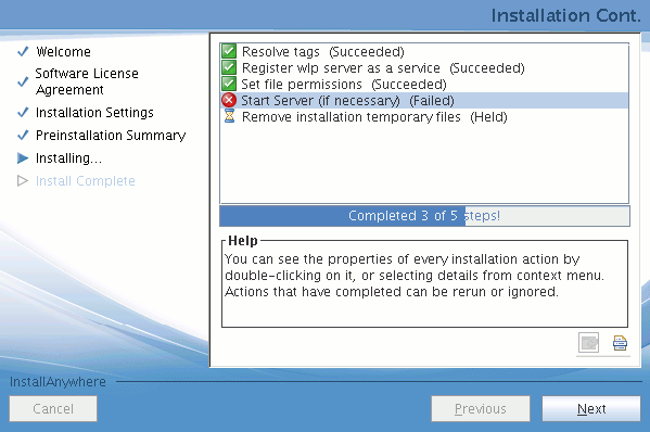

  1. If you encounter a problem, double-click the line that contains the step name, or right-click it and select Details. The line is indicated by a red icon.
    The image presents an example of a failure of an installation step.
