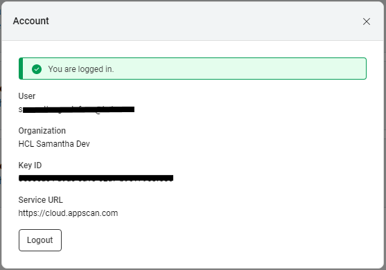

Account information
To access account information, select .
If you are not currently logged in to AppScan 360°, first provide a key ID and key secret. AppScan Go! identifies and populates the Service URL field with the appropriate information.

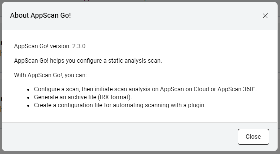

- Select to access the About AppScan Go! dialog box.

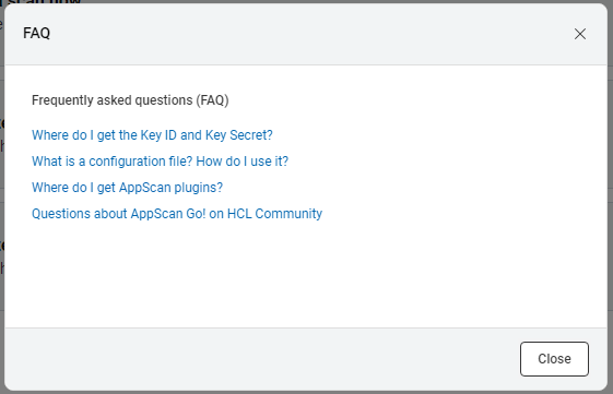

- Select to access the FAQ dialog box.
Click on any of the questions to launch the online help in a new browser tab with information answering the question.
