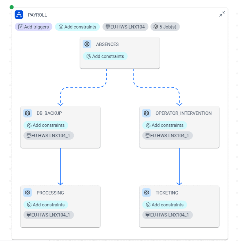

Example:
The PAYROLL job stream starts with the ABSENCES predecessor job, followed by two conditional branches of jobs that can run. The branch that runs depends on the outcome of the ABSENCES job, as defined by its output conditions.
If the output conditions are not satisfied, the HCL Workload Automation places the omitted successor jobs in the SUPPRESSED state. This behavior differs from regular dependencies, where the system places successor jobs in the HOLD state until the predecessor reaches a successful (SUCC) state. Predecessors can be either jobs or job streams.
A job stream showing a predecessor job that then branches out to two different successor jobs

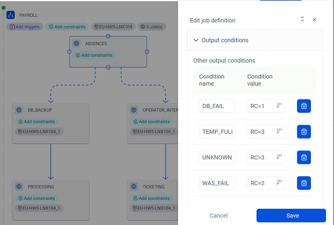

A condition establishes a conditional dependency relationship. You specify output conditions directly within the job definition, and you can define an unlimited number of dependencies. When you add a conditional dependency to a job, you select the exact status and output conditions that the system evaluates during processing.
Example:
The following example illustrates other output conditions defined within a job definition:
Job properties General Information tab displaying other output conditions set in the job definition.
You can define both successful output conditions (which signify a successful job run) and alternative output conditions (which determine which successor job starts). HCL Workload Automation evaluates these output conditions using OR logic.

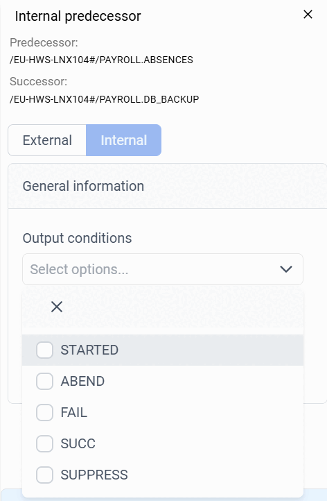

When you add this job to a job stream as a successor job and apply a conditional dependency to the preceding job (the predecessor), you select the required conditions. The Properties panel for the internal or external dependency dynamically updates to include the conditions from the job definition. In addition to these default conditions, you can select conditions based on job status. If the selected conditions are satisfied during job processing, the corresponding successor job runs.
Properties of an internal job dependency showing the conditions that were previously set in the job definition
