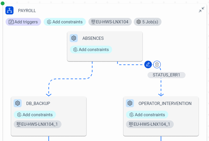

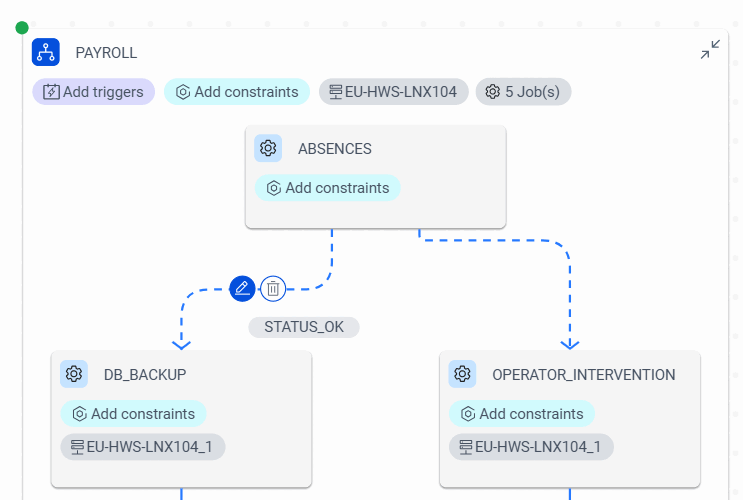

The DB_BACKUP job runs if the ABSENCES job satisfies the condition associated with STATUS_OK. The OPERATOR_INTERVENTION job runs if the ABSENCES job satisfies the condition defined for STATUS_ERR1.
The predecessor job Absences has an internal conditional dependency on DB_BACKUP
The predecessor job Absences has an internal conditional dependency on OPERATOR_INTERVENTION

  6. Define the internal conditional dependencies:
    1. From the ABSENCES job block, drag a connecting arrow to the DB_BACKUP connection point.
    2. From the Internal predecessor panel, in General information, expand the Output conditions menu and select STATUS_OK.
    3. From the ABSENCES job block, drag a connecting arrow to the OPERATOR_INTERVENTION connection point.
    4. From the Internal predecessor panel, in General information, expand the Output conditions menu and select STATUS_ERR1.
