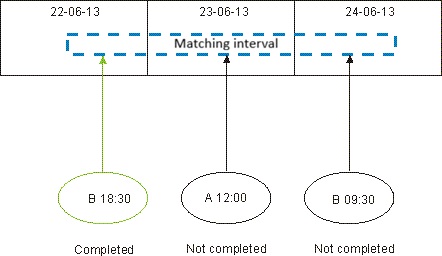

In situations were a possible match can be found also after the IA time of the successor, the scheduler first checks if there is a match with a completed predecessor before the IA time. If it finds it, it considers the dependency as resolved and does not add it in the plan. For example, operation A with a IA time at noon of 23-06-2013 is defined in the database with B as external predecessor. The match is to be looked for within an absolute interval spanning from 18:00 of the day before to 20:00 of the day after the IA time of A.
There are two possible matches of B to resolve this dependency:
  • B with IA time equal to 18:30 of 22-06-2013 that has completed.
  • B with IA time equal to 09:30 of 24-06-2013 that has not yet completed.
A match is found with the instance of B that completed on 22-06-2013: the dependency is considered solved and is not added to the long-term plan.
