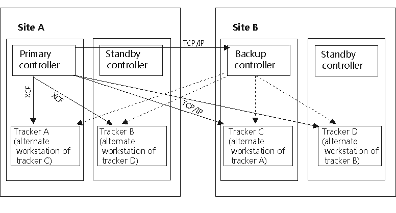

Configuring trackers, primary controller, and backup controller shows two remote sites, with two images each.
Figure 1. Configuring trackers, primary controller, and backup controller
In this configuration:
  • The primary controller is connected to trackers A and B through XCF links. It is connected to the backup controller, trackers C and D through TCP/IP.
  • The backup controller connects to trackers A, B, C, and D through TCP/IP links when you issue the MODIFY command /F procname,BKTAKEOVER and the backup controller becomes the controlling system.
  • On the primary controller you set the following statements:
    OPCOPTS  OPCHOST(YES)
    BKPTOPTS TCPIPJOBNAME('TCPIP')
             HOSTNAME('1.11.111.111')
             LOCPORTNUMBER(7543)
             PEERHOSTNAME('2.22.222.222')
             PEERPORTNUMBER(6456)
    ROUTOPTS XCF(HWA2)                       1
  • On the backup controller you set the following statements:
    OPCOPTS  OPCHOST(BACKUP)
             LOCPORTNUMBER(6456)
             PEERHOSTNAME('1.11.111.111')
             PEERPORTNUMBER(7543)
    ROUTOPTS TCPIP(HWA2:'3.33.333.333'/4348)1
  • On trackers A and B you set the following statements:
    TRROPTS  HOSTCON(XCF)
             BKPHOSTNAME('2.22.222.222')
             BKPPORTNUMBER(924)
    XCFOPTS GROUP(GRUXCFX)
            MEMBER(HWA2)
    TCPOPTS  HOSTNAME('3.33.333.333')
             TRKPORTNUMBER(4348)
  • On trackers C and D you have set the following statements:
    TRROPTS  HOSTCON(TCP)
             TCPHOSTNAME('1.11.111.111')
             TCPPORTNUMBER(424)
             BKPPORTNUMBER(924)
             TRKPORTNUMBER(4348)
1
On the primary and backup controller, the destination name in the ROUTOPTS statement must be the same (HWA2, in this example).
