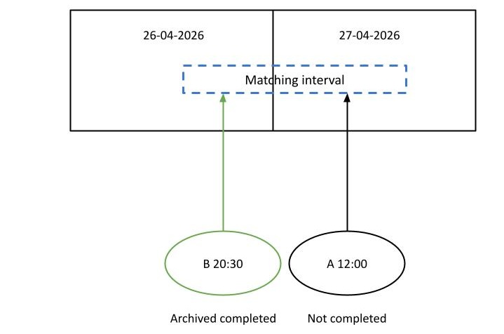

For example, operation A with an IA time at 12:00 of 27-04-2026 is defined in the database with B as external predecessor. The match is to be looked for within an absolute interval spanning from 14:00 of the day before to 16:30 of the same day of the IA time of A.
The only match that can resolve the dependency is B with IA time equal to 20:30 of 26-04-2026 that is in completed status and has been archived.
If the MPRESOL parameter in the JTOPTS statement is set to DP or NO (default), a match is not found and the successor is flagged as mandatory pending. If MPRESOL is set to ARCHIVEDOCC, a match is found with the instance of the archived completed operation B with IA at 20:30 of 26-04-2026: the dependency is considered resolved and is not added to the current plan.
