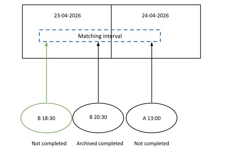

For example, operation A with an IA time at 13:00 of 24-04-2026 is defined in the database with B as external predecessor. The match is to be looked for within an absolute interval spanning from 18:00 of the day before to 13:30 of the same day of the IA time of A.
Two possible matches of B can resolve the dependency:
  • B with IA time equal to 20:30 of 23-04-2026 that is in completed status and has been archived.
  • B with IA time equal to 18:30 of 23-04-2026 that has not yet completed.
A match is found with the instance of B with IA equal to 18:30 of 23-04-2026: the mandatory dependency is considered resolved and becomes a normal dependency in the current plan.
