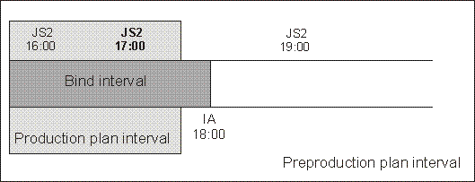

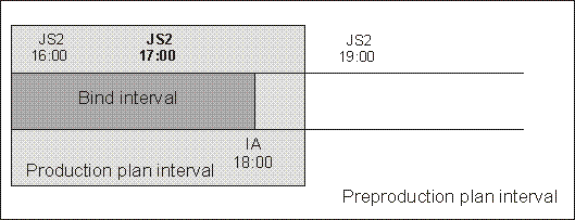

Scenario 1: The production plan contains the instance of job stream
JS2 that closest precedes the shadow job input arrival.
the JS2 instance that closest precedes the shadow job input
arrival is selected for the bind. This means that the shadow job and
the remote job stream instance are now associated. If, at a later
time, a new instance of JS2 that more closely precedes the shadow
job input arrival is submitted ad hoc in the remote engine plan, the
match with the JS2 instance selected for the bind is not modified.
One
of the following situations can now occur:
The selected JS2 instance contains JOB2
The bind is established and a notification containing:
The remote job information identifying the JOB2 instance in the
remote engine plan
The current status of that JOB2 instance in the remote engine
plan
is sent back to the HCL Workload Automation for Z controller,
the shadow job instance is updated with the remote job information,
and its status is updated accordingly.
The selected JS2 instance no longer contains JOB2 because it was
either canceled or completed, and was removed from the production
plan.
The bind is established and a notification informing about the
successful execution status is sent back to the HCL Workload Automation for Z controller.
The shadow job instance is marked as completed. Its successors can
start.
The selected JS2 instance contains JOB2, but JOB2 is in canceled
status
start.

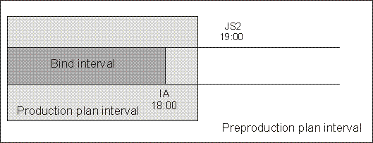

Scenario 2: The production plan interval contains the input arrival
of the shadow job, but no instances of job stream JS2 exist.
Figure 3. The input
arrival of the shadow job is included in the production plan but no
instance to bind exists
In this case, the bind with JOB2 fails. A notification
informing that the bind failed is sent back to the HCL Workload Automation for Z controller,
and the shadow job status is updated according to what you set in
the Complete if bind fails field.

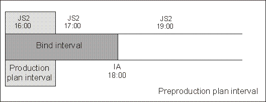

Scenario 3: The preproduction plan interval contains the input
arrival of the shadow job and the production plan does not yet include
the closest preceding JS2 instance.
Figure 4. The instance
to be bound exists but it is not yet included in the production plan
A notification informing that
the bind is established is sent back to the HCL Workload Automation for Z controller
and the status of the shadow job is set to "READY-The bind was established".

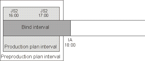

Scenario 4: The preproduction plan interval still does not contain
the input arrival of the shadow job.
Figure 5. The preproduction
plan interval still does not contain the input arrival of the shadow
job
In this case, the bind request
is put on hold until the preproduction plan is extended to include
the shadow job input arrival. Until then the status of the shadow
job remains "READY-Waiting for bind result".
