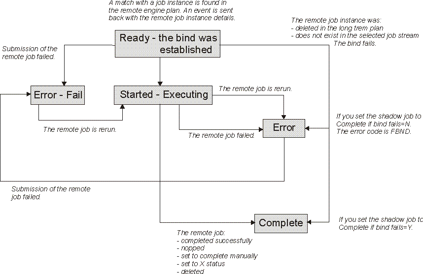

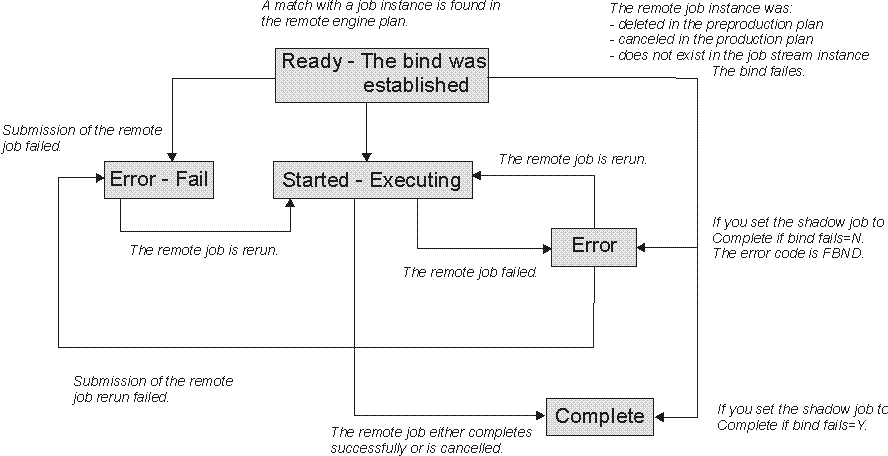

If the remote job instance has already completed successfully when the match is done, the shadow job status becomes C immediately.
If the shadow job ends in ERROR, an error code explains why the job failed. For example, if the job failed because the bind failed then the error code is FBND.
ERROR status is not considered a final status for the shadow job, because the remote job instance bound can be rerun at a later time. Only status C is considered as the final status for a shadow job.
As soon as the shadow job status satisfies the dependency rule, the dependency of the local job from the shadow job is resolved, and the cross dependency for the local job on the remote job is also resolved.
