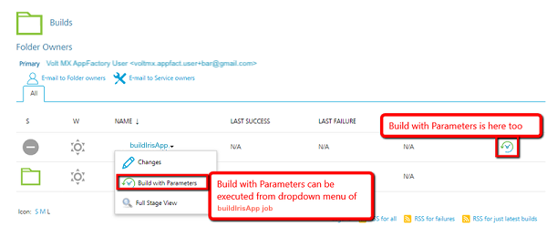

  1. From the folder of your App Factory project, navigate to Iris → Builds → buildIrisApp
  2. Run the job by using the Build with parameters option. You can access the option by following either of these steps.
    Note: If you don’t see the option, you might not have ownership permissions to the project. You can verify whether your name is listed in the Folder Owners section of the project. The Primary owner of the project can add users as secondary owners to grant permissions to the builds.
    • On the right-side of the job row, select the icon that represents Build with Parameters.
    • Open the drop-down list for the buildIrisApp job, and then select Build with Parameters.
    • Open the buildIrisApp job and then click Build with Parameters action on the left panel.
