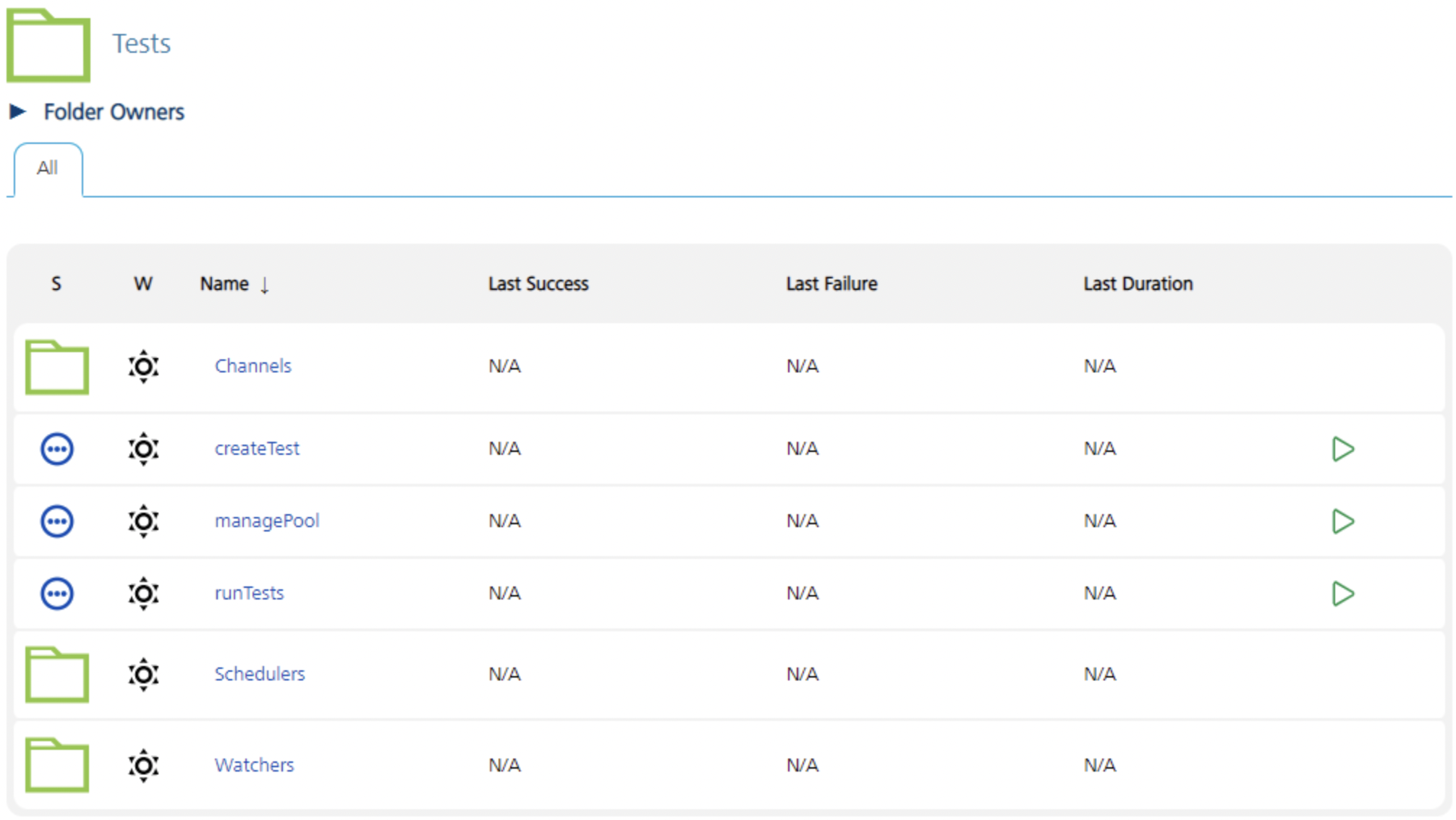

Tests
The Tests folder contains jobs to create tests, run tests, and manage device pools. It also contains sub-folders that store the created tests based on the trigger mechanism.
For more information, refer to the following sections:
Triggers
The Triggers folder contains the createTrigger job, which creates a trigger to perform a build based on a schedule or based on a push to the source code. There are two sub-folders that store the created triggers based on the trigger mechanism.

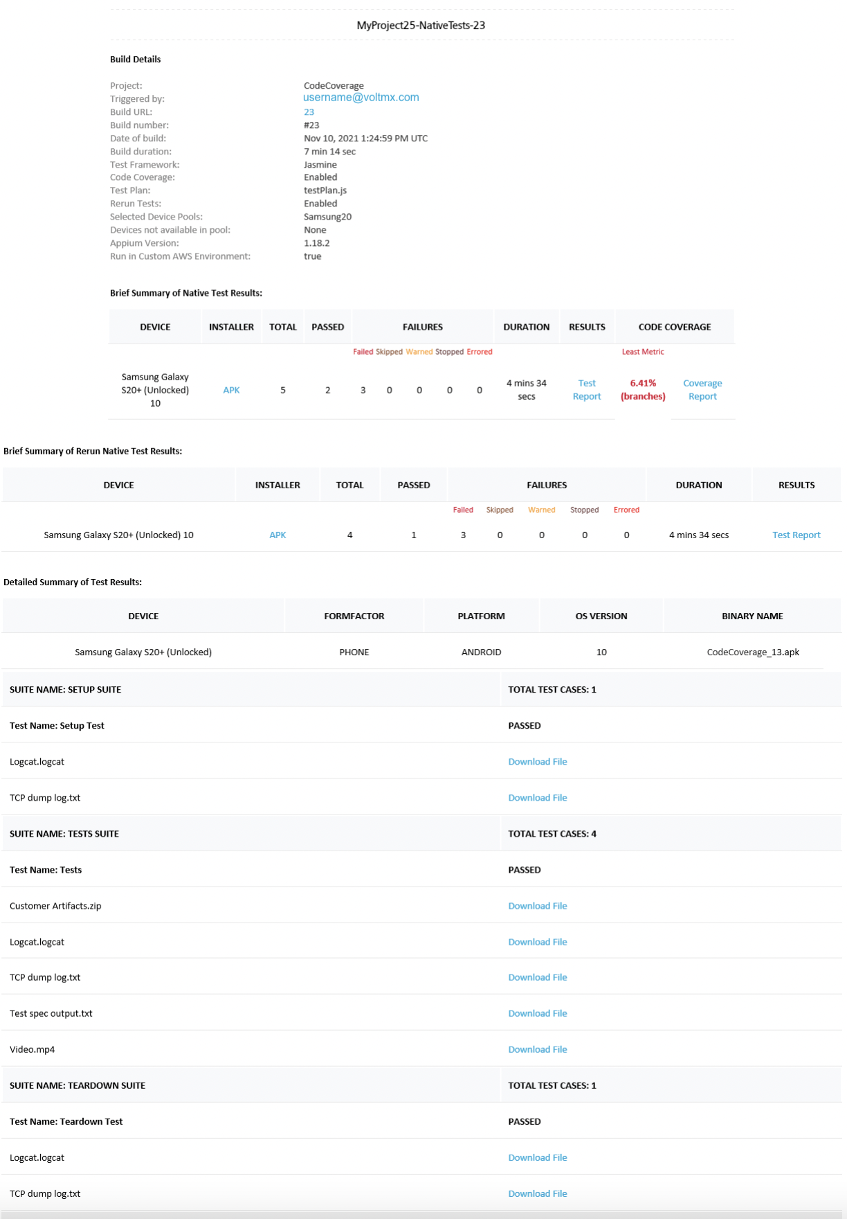

Native Test Results
This section contains a brief summary and a detailed summary of the tests that are run on your native apps.
If you enabled rerunning of failed test cases, this section contains a brief summary of the rerun test cases. If you enabled code coverage for your tests, the brief summary contains a Code Coverage Report.
AWS Custom Environment Run
The test results section also contains information about the Appium Tests that are run on a custom AWS environment. This section contains links to the following files:
  • Logcat.logcat
  • TCP dump log.txt
  • Test spec output.txt
  • Video.mp4
  • Customer Artifacts.zip
The Customer Artifacts.zip file contains the test output contents. The Test spec output.txt file contains the AWS console output of the tests that are run on the Custom Environment.

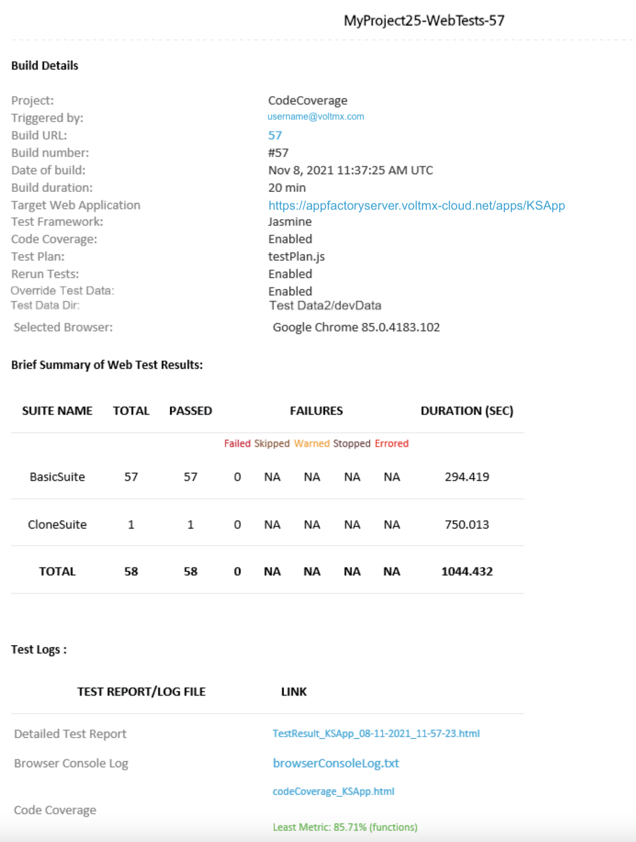

Web Test Results
This section contains a brief summary of the tests that are run on your web app. It also contains links to test logs such as the Detailed Test Report and the Browser Console Log.
If you enabled Code Coverage for your tests, the Test Logs section contains a code coverage report.
