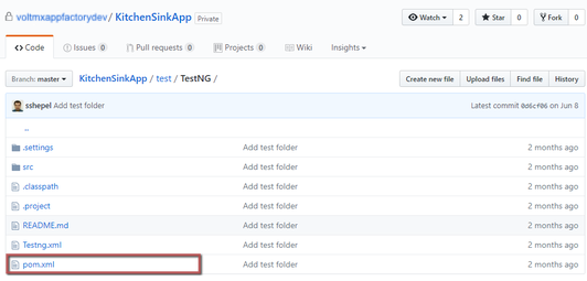

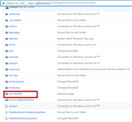

- Make sure that the Iris project contains the Appium test files at the following location:
<Project-Root>/test/TestNG/
- Make sure that you configure a device pool before you test the application
For information about device pools, refer to Configuring Device Pools -
The Appium tests must be compatible with AWS Device Farm because the Appium tests are executed in the AWS Device Farm Cloud environment
Note: You can find the Appium tests in the root folder of the project.
Tests must be compiled by using a Maven configuration file (pom.xml) that is available in the Tests root folder (

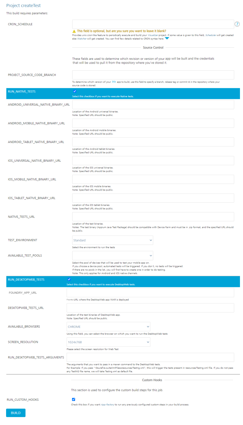

To build and run a test, follow these steps:

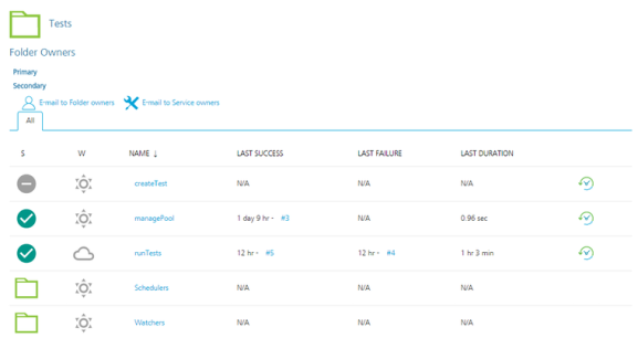

- From the Iris folder of your project, navigate to the Tests sub-folder.
- For the runTest job, click the Build with Parameters icon on the right side of the row.
Alternatively, select the runTest job, and then from the left panel of the details page, select Build with Parameters. - Configure the build parameters for the runTest job. For more information about the parameters, refer to the following sections.
Source Control
Parameter | Description |
PROJECT_SOURCE_CODE_BRANCH |
Specifies the branch, release tag, or the commit ID of the repository that contains the test files.The tests must be placed at the following location:<Repository-Root>/<Project-Root>/test/testNG/ The <Repository_Root> must be configured in the Project Settings. The <Project-Root>is the name of the project that is configured while creating the Iris project in App Factory. |
Testing
RUN_NATIVE_TESTS | Specifies whether App Factory must run tests for the Native platform.If you enable this parameter, the console displays additional parameters for Native tests. For more information, refer to Native build parameters. |
TEST_FRAMEWORK | Specifies the framework that you want to use for testing the app. The test framework can be TestNG or Jasmine. |
RUN_DESKTOPWEB_TESTS | Specifies whether App Factory must run tests for the Desktop Web platform.If you enable this parameter, the console displays additional parameters for Desktop Web tests. For more information, refer to Desktop Web build parameters. |
ANDROID_UNIVERSAL_NATIVE_BINARY_URL | Specifies the URL of the Android universal binaries that are generated by a build job or generated locally. |
ANDROID_MOBILE_NATIVE_BINARY_URL | Specifies the URL of the Android Mobile binary that is generated by a build job or generated locally. |
ANDROID_TABLET_NATIVE_BINARY_URL | Specifies the URL of the Android Tablet binary that is generated by a build job or generated locally. |
IOS_UNIVERSAL_NATIVE_BINARY_URL | Specifies the URL of the iOS universal binaries that are generated by a build job or generated locally. |
IOS_MOBILE_NATIVE_BINARY_URL | Specifies the URL of the iPhone binary that is generated by a build job or generated locally. |
IOS_TABLET_NATIVE_BINARY_URL | Specifies the URL of the iPad binary that is generated by a build job or generated locally. |
NATIVE_TESTS_URL | Specifies the URL of the binaries for the compiled test project. If you provide Git parameters, you can skip this parameter. |
TEST_ENVIRONMENT | Specifies the environment on which the Device Farm runs the test. You can select a Standard Test Environment, or select a Custom Test Environment.For more information, refer to Native Testing Environments.If you select a Custom Test Environment, the console displays additional parameters. For more information, refer to Custom Test Environment parameters. |
AVAILABLE_TEST_POOLS | Specifies the device pool that must be used for the tests. If a device pool is empty, the build fails.For more information, refer to Configuring Device Pools. |
APPIUM_VERSION | Specifies the Appium version that is used to run the tests. For information about the artifacts that are available in the notification mail for AWS Custom Environment Run, refer to Building an App in AWS Custom Environment. |
TESTNG_FILES | Specifies the relative path of the TestNG.xml file in the test jar file, for example: appfactory/Testng.xml .If the path is not specified, the root of the test jar file is taken as the default path.You can specify multiple file paths by using comma separated path values. For example:voltmx/Testng.xml,voltmx/appfactory/Testng.xml,testng.xml Note: If the specified TestNG file is not found in the source, the tests run independently similar to Standard Test Environment. |
FOUNDRY_APP_URL | Specifies the URL of the Foundry app with which the Desktop Web WAR file is published. |
DESKTOPWEB_TESTS_URL | Specifies the URL of the Desktop Web binary that is generated by a build job or generated locally. |
AVAILABLE_BROWSERS | Specifies the browser on which you want to run the Desktop Web tests. |
SCREEN_RESOLUTIONS | Specifies the resolution at which the browser must launch and run the tests. |
RUN_DESKTOPWEB_TESTS_ARGUMENTS | Specifies additional arguments (parameters) that must be passed in the Maven command for the Desktop Web tests.For Example: If you pass -Dsurefire.suiteXmlFiles=resources/Testng.xml, the argument triggers the tests from the resources/Testng.xml file. If you do not pass the argument, Testng.xml is selected as a default file. |

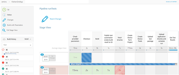

Standard Test Environment Run
The test run process consists of the following steps:
- Checkout of test project if GIT_BRANCH and GIT_CREDENTIALS are selected.
- Build the test project
- Publish test binaries at S3 based on the
<S3 bucket>/<project name>/Tests/runTests/<build number>/KitchenSinkApp_TestApp.zip
. For example:https://s3-eu-west-1.amazonaws.com/ voltmxdemo/KitchenSinkApp/Tests/runTests/4/KitchenSinkApp_TestApp.zip
- Fetch binaries to run them in AWS Device Farm
- Create a project in AWS Device Farm
- Create a device pool at AWS Device Farm, taking a device list selected from the configuration
- Upload test binaries to the Device Farm
- Upload application binaries to the Device Farm and schedule a run.
- Retrieve the test results.

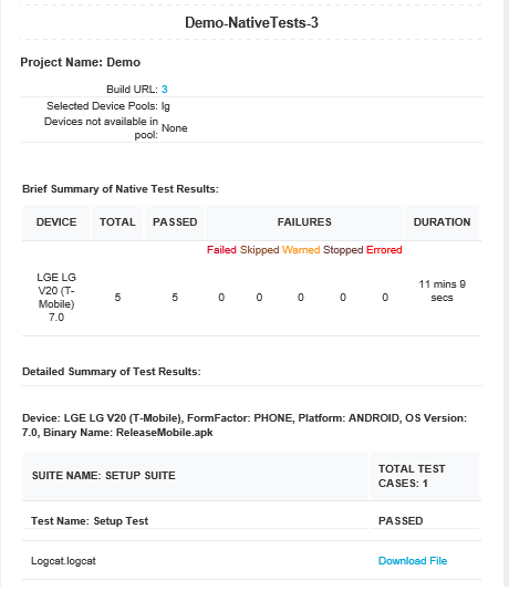

When the project test build is complete and the test results are published at S3, e-mail notifications are sent to recipients:
On unsuccessful build for the tests run, the following e-mail is sent to the recipients:
In the final stage, the consolidated test run status is notified via e-mail. Refer the following screenshots for the sample email for consolidated status.
Sample email for Native tests
To download test data fetched from AWS Device Farm, click Download File link. Data is stored at S3 and available for review without time limitations.

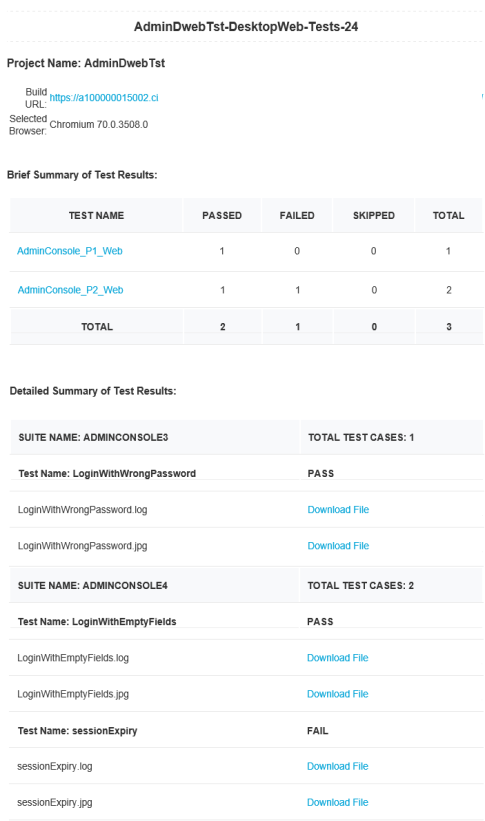

Desktop Web Test Results
Sample email for DesktopWeb tests
The summary of the test results are shown based on the tests executed on specified browser that includes passed, failed, skipped. Usually the tests are skipped when the driver initialization fails.
You can click the respective links in Brief Summary table to view the test summary.
To download the log files for each test case, click the respective Download File link. If you have any test failures, you can use these files to debug them.

FAILED: The status of the test result is FAILED when the expected result does not match with the actual result of the test case, the assertion will fail and hence the test case status will be set to FAILED.
SKIPPED: Following are the scenarios where a test case can be skipped while testing, and the status of the test result can be SKIPPED.
- AWS Issue: AWS skips the test cases yet to run when the duration of the test run exceeds 150 minutes (AWS Device Farm default time limit) resulting in the SKIPPED status. This is applicable only for Native test results.
- TestNG issue: There are various scenarios where TestNG can skip the test cases during a test run. The most common scenario is, if a parent test case fails for any reason, TestNG will skip all the related child test cases, and the status of the test result is SKIPPED.
WARNED: The status of the test result is WARNED when the device farm returns any warning due to the issues from AWS.
STOPPED: The status of the test result is STOPPED when you abort the test case forcefully.
ERRORED: The status of the test result is ERRORED when the device farm returns any error due to the technical issue on AWS.
Note: WARNED, STOPPED, and ERRORED statuses are not applicable for DesktopWeb tests.

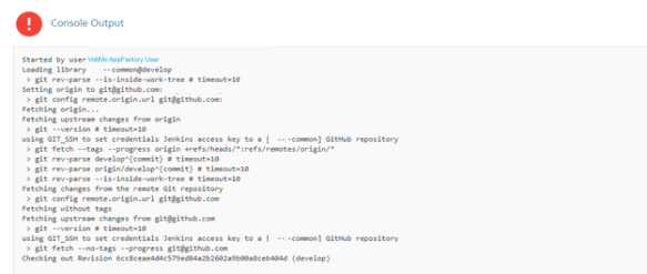

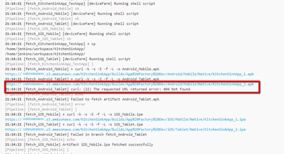

The builds that failed during the test can be tracked for the issues that caused the failure. For example, consider build #4 from the following screenshots of runTests job. To troubleshoot the issue, follow these steps.
- From your project folder, navigate to Iris > Tests.
- Select the runTests job, and then find the failed build.
For example, find and click the link for build #4.
- From the details page of the failed build, select the Console Output on the left panel. The Console Output Log opens in the right pane.
- Scroll to find errors in the log that caused the build to fail. For example, you can trace an error that is related to invalid Android Tablet URL.
- Check if the ANDROID_TABLET_NATIVE_BINARY_URL parameter is valid.

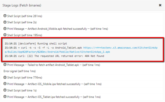

Alternatively you can troubleshoot the issue from the stages of Manual Testing.
To troubleshoot the issue from the Stage View, follow these steps:
- From the Stage View, point to the failed stage, and then click Logs.
- From log messages in the Stage Logs window, identify the error message that corresponds to the failure of the build.
- Check whether the ANDROID_TABLET_NATIVE_BINARY_URL parameter is valid.

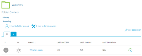

Auto Triggering Tests
Currently, there are two types of auto-triggered test jobs: scm-triggered (Watchers) and cron-triggered (Schedulers). Every project structure has folder called "Tests" in "Iris" sub-folder, that contains job for creation of auto-triggered jobs (createTrigger) and two sub-folders where created jobs are stored.
To setup auto-triggered job, perform the following steps:
- Go to Tests folder under project's root folder.
Click on createTest job.
Provide all required parameters (they are the same as in "Facade" job).
Important: Please note, that there is one additional parameter, which is called "CRON_SCHEDULE". If "CRON_SCHEDULE" parameter is given, then a cron-triggered job is created and stored in "Schedulers" sub-folder. If the parameter is not provided, a scm-triggered job is created and stored in "Watchers" sub-folder.
Check that the createTest job is complete.
Important: Every Scheduler that is created, will have cron string in job's name to simplify the job search. Refer the image below.
Important: Every Watcher that is created contains the branch name in the job name to simplify job search.
