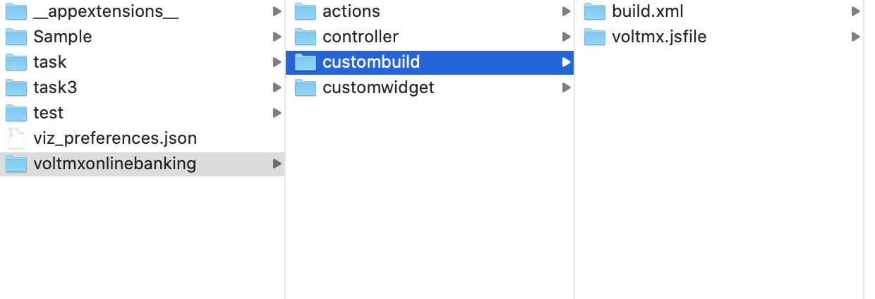

  1. Navigate to the location of your project. For example, <your workspace folder>/<appid>/.
  2. Create a New Folder with the name custombuild.
  3. In the custombuild folder, create a new file, build.xml.
  4. In the build.xml file, create an ANT task, postbuild.

  1. Navigate to the location of your project. The path may look like <your workspace folder>/<appid>/
  2. Download the custombuild.zip file
  3. Copy the securejs.properties file received over customer service ticket into <your workspace folder>/<appid>/custombuild folder.
  4. To exempt certain files from protection do the following, in the custombuild folder, create a text file excludefilelist.txt. In the text file, add sections of the application(you can add both files and/or directors) to exclude.
