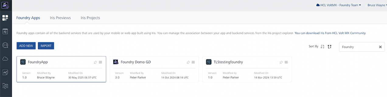

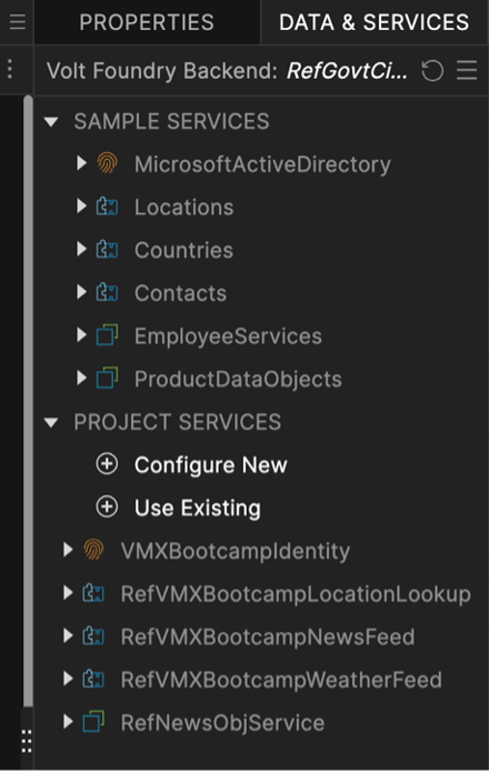

  4. To publish to Volt MX Foundry, your Volt MX Iris client app must be associated with a Volt MX Foundry app, which means that you need to either create a new Volt MX Foundry app or use an existing one. To do so, at the upper-right corner of the Data & Services panel, click the hamburger menu icon hamburger menu icon , and then click either Create New App or Link to Existing App. From the Volt MX Foundry Application dialog box, select the app to which you want to associate your Volt MX Iris app. For more information about how to create a new Volt MX Foundry app, refer How to Add Applications in the Volt MX Foundry Console User Guide.
    Once you link your Volt MX Iris client app with a Volt MX Foundry app, the name of the linked Volt MX Foundry app is displayed beside Foundry Backend on the Data & Services panel. Here, App 1 is the associated Volt MX Foundry app.

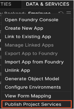

  5. Right-click Volt MX Foundry for the linked app, and then click Publish Project Services. The app is successfully published to Volt MX Foundry.

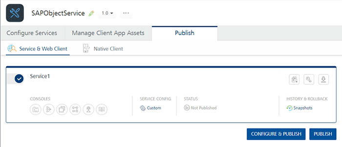

Once you have selected a Volt MX Foundry app to which you want to bind your Volt MX Iris app, the Volt MX Foundry Console opens. On the Volt MX Foundry console, click the Publish tab.
The status of the environment to which you want to publish the client app indicates whether the Volt MX Foundry app has been published.
Status when Not PublishedStatus when Published

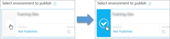

  1. If the Volt MX Foundry app to which you have bound the client app has not yet been published, select the app for publish.
  2. Click Next. The Environments page appears.

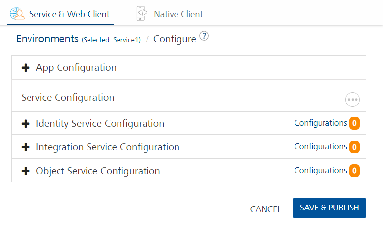

  3. The Configure page displays options to change the configuration of your Services. To make any changes, click + Service Configuration., and then click any of the blue-text fields.
    Note: If your app is an upload of web app ( such as SPA, Desktop Web/Responsive Web, or Progressive Web App) binary , the Configure page displays a drop-down list of options specific to the web client environment.
  4. If available, you can reconfigure the application-level settings and service configuration settings from this page .

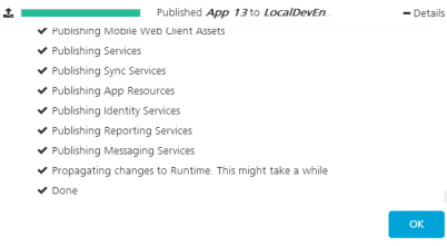

  5. Click Save and Publish. The app and any associated services are published to the selected environment.

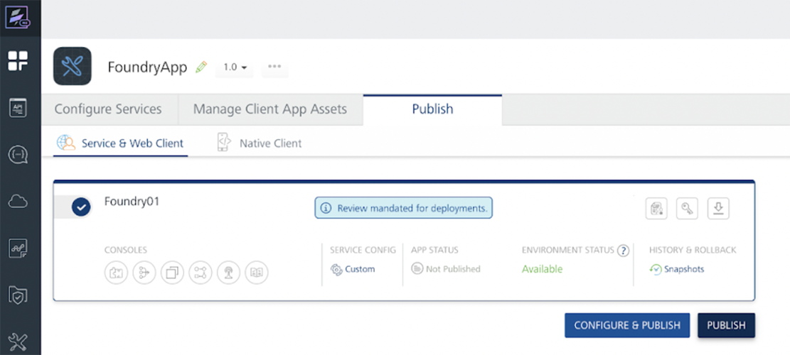

Publishing with Governance Enabled
When Governance is enabled for the selected environment, Developers must submit a review request instead of deploying the app directly. The request gets queued for review and approval by an Approver or Admin before the app can be deployed.
Raise a Review Request
To raise a review request for your app from Volt Foundry, follow these steps
  1. Open the Foundry Console and navigate to your app.
  2. Select the target Environment where you want to publish under the publish tab.

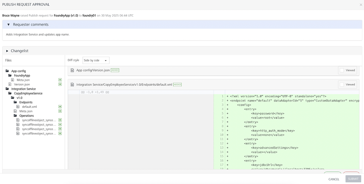

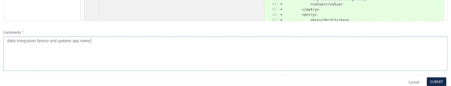

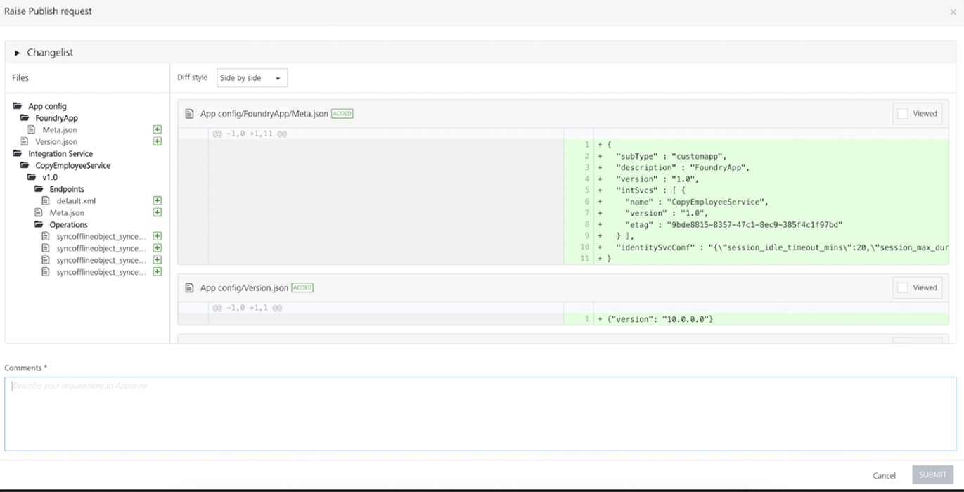

  3. Click Publish — if governance is enabled, a Raise Publish Request form appears.
  4. Review the changes and enter Comments for the request. Click Submit.
    NOTE: All Foundry app services published till now will be shown as a change under the diff viewer in the first publish review request.

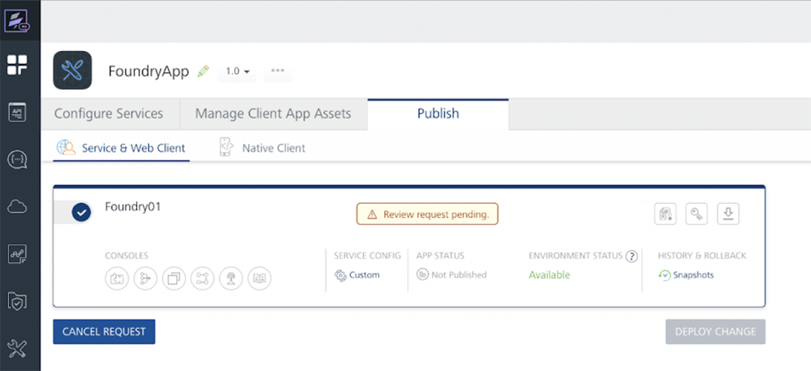

  5. The publish request is now queued for review and approval.

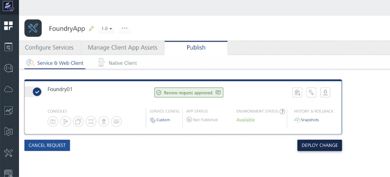

  6. Once the request is approved, click Deploy Changes to deploy the app.
    Note: App changes cannot be directly deployed to Governance enabled environments.

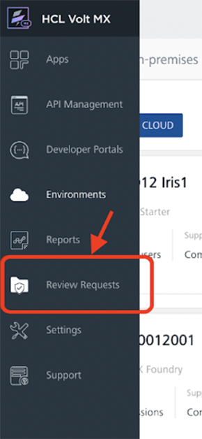

Review and Approve/Reject a Request

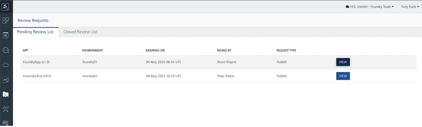

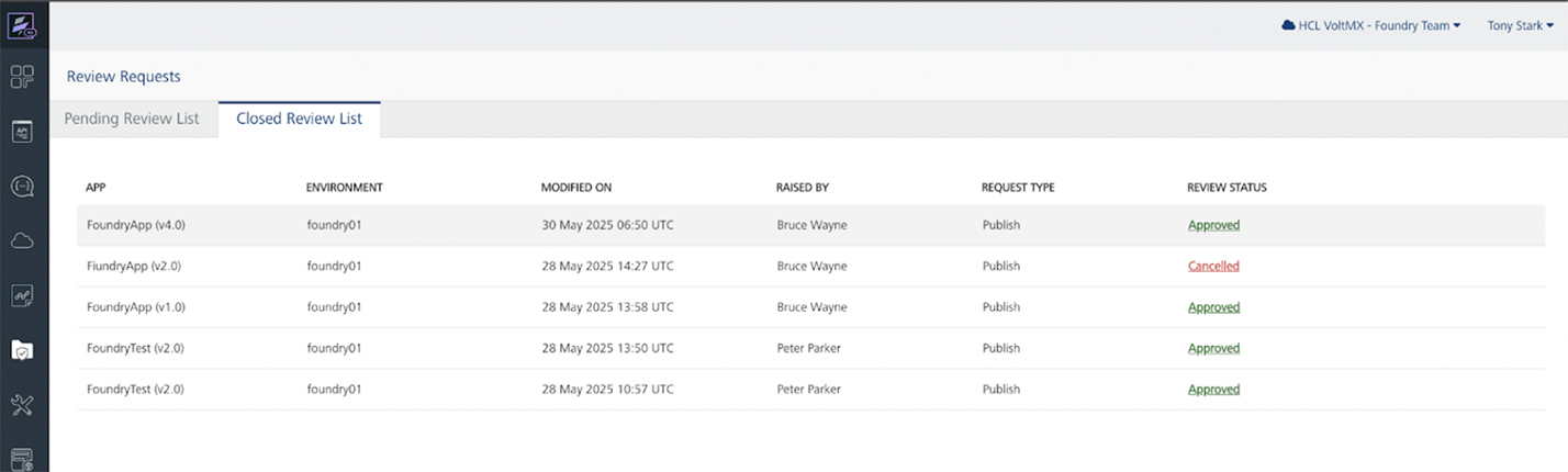

  1. Open the Foundry Console.
  2. From the left sidebar, click Review Requests (visible only to Approvers/Admins).
  3. Locate the pending request under the Pending Review List tab with the appropriate environment and app.
  4. Click the View button for the request to view the Review Request details.

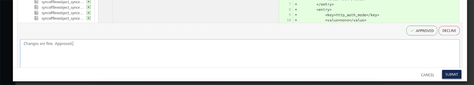

  5. Choose to Approve or Reject the request and enter a comment.
  6. Upon approval, the app is ready to be deployed by the developer. If rejected, the submitter is notified with the reason.
  7. Approved or rejected requests can be viewed under the Closed Review Requests tab.
