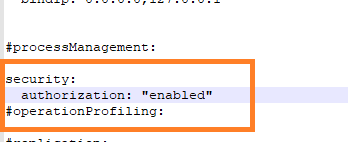

  5. Make the following changes in mongod.cfg and refer to the screenshot below.
    Figure 1. MongoDB Installation – Start MongoDB Service (non-HA) (Cont.)
