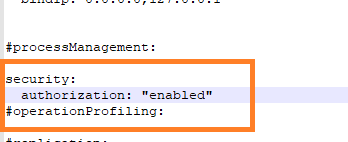

  4. Make the following changes in mongod.cfg. Refer the screenshot below:
    Figure 1. Enable Authentication
    A screenshot of a computer Description automatically generated
