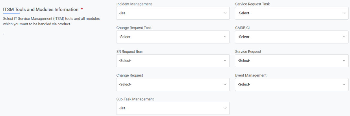

Sub-Task Management
For Integration of Jira ITSM Sub-Task with iAutomate tool, perform the following steps:
Figure 1. Integration of Jira ITSM Sub-Task

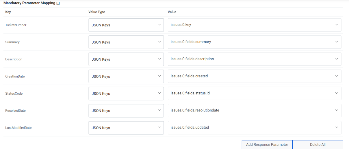

  3. Mandatory Parameter Mapping:
    Figure 2. Mandatory Parameter Mapping

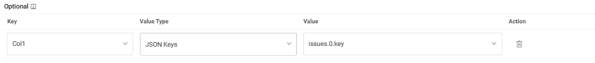

  4. Optional:
    Figure 3. Optional

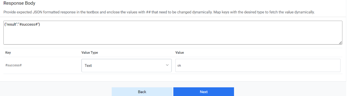

  7. Response Body:
    {"result":"#success#"}
    Figure 4. Response Body
