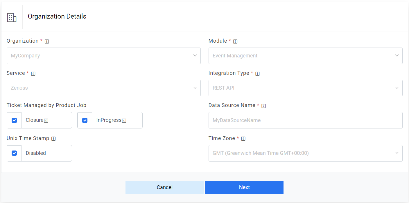

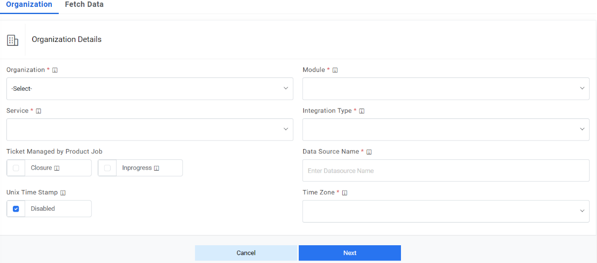

  4. On the Organization tab,
    1. Select the Organization Name from the dropdown.
    2. Select the Module as Event Management, since we are configuring this data source for pulling the event data.
    3. Select the Service as Zenoss Tool as we are configuring the data source for Zenoss
    4. Select the Integration Type as REST, since we will be integrating through REST APIs.
    5. Check Is Ticket Closure Managed by iAutomate job if you want iAutomate to manage the issue closure updates instead of the RBA tool. In this scenario, an additional tab Close Rules Configuration will be activated to provide further details, steps for which are mentioned later.
    6. Check “Is ticket InProgress Managed by iAutomate job” if you want iAutomate to manage the issues in progress status updates instead of the RBA tool. In this scenario, an additional tab “InProgress Rules Configuration” will be activated for providing further details, steps for which are mentioned later.
    7. Select the Timezone to specify the time zone of the selected data source.
    8. Select Timestamp to view the present data with date and time.
    9. Click Next.
    Figure 2. Create Data Source (Cont.)

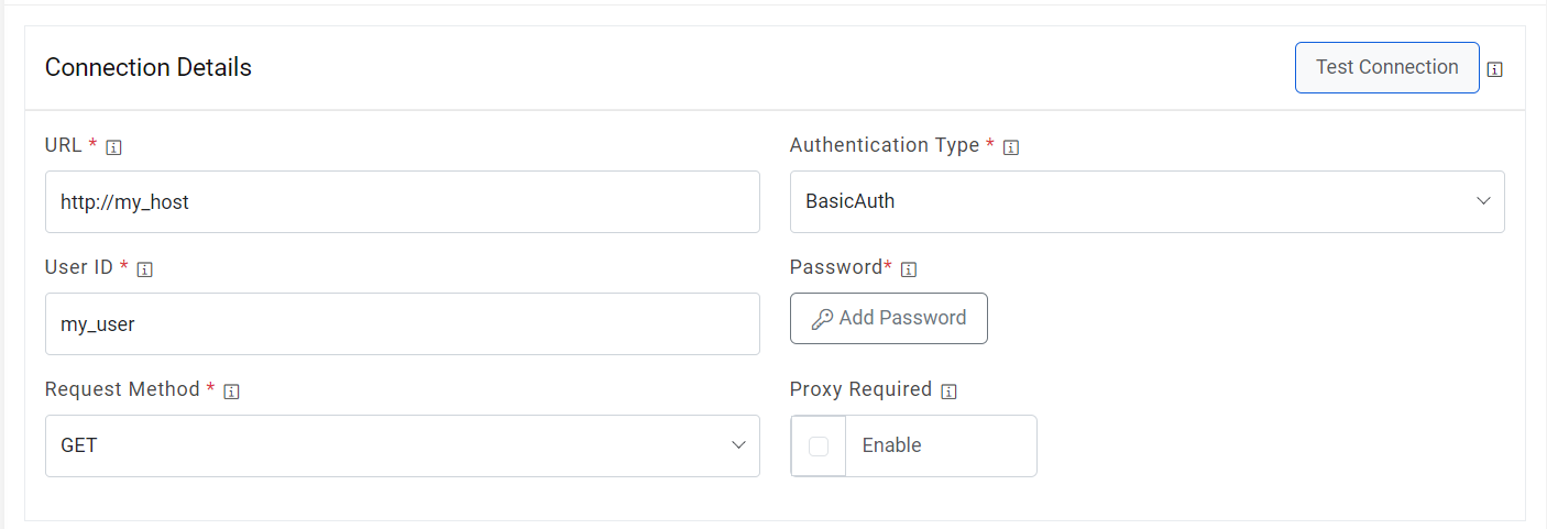

  6. In the Connection Details section, enter the following details:
    1. URL – Type the URL which contains the placeholders that display the parameters based on the applied clause such as the number of records to be fetched, query type, date on which the data is fetched, and the order by and so on. It depends on the URL or API provided by the tool.
      Sample URL - https://url.servicenow.com/api/now/v1/table/sc_request?sysparm_fields=#Columns
    2. Authentication Type - Select one of the Authentication Types from NoAuth / Basic / Windows
      1. Selection of Basic / Windows requires you to enter -
        • User Id
        • Password
    3. Request Method - Select Request Method as POST from the drop-down.
    4. Proxy Required - Check Proxy Required, if the environment needs access to content from data sources outside the firewall.
    5. Click on Test Connection to check accessibility of URL from service. Testing the connection is not mandatory, you can still create Data source.
    Figure 4. Create Data Source (Connection Details)

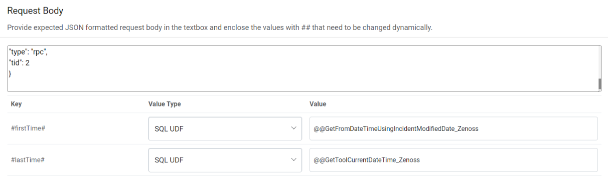

  8. Request Body - As request method selected earlier is POST, please enter the body of URL. A sample response is mentioned below -
    Request Body –
    {"action": "EventsRouter","method": "query",
    "data": [{
    "keys": ["evid", "summary", "eventState", "severity", "eventClass", "ownerid", "firstTime", "lastTime", "count", "eventClassKey", "message"],
    "params": {
    "eventState": [0, 1], "severity": [5],
    "excludeNonActionables": false,
    "firstTime": "#firstTime# TO #lastTime#","eventClass": []},
    "limit": 200,
    "sort": "firstTime",
    "dir": "ASC",
    "start": 0,
    "uid": "/cz0/zport/dmd"
    "type": "rpc",
    "tid": 2
    Figure 5. Create Data Source (Connection Details)

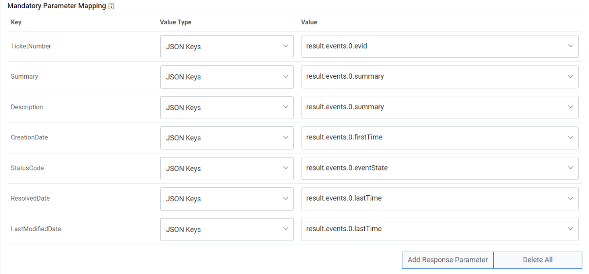

  11. Mandatory Parameter Mapping – Please map the mandatory parameters to the respective values as mentioned in the screenshot below:
    Sample Mandatory Parameter Mapping
    Key Value Type Value
    TicketNumber JSON.Keys result.0.evid
    Summary JSON.Keys result.events.0.summary
    Description JSON.Keys result.events.0.message
    CreationDate JSON.Keys result.events.0.firstTime
    StatusCode JSON.Keys result.events.0.eventState
    ResolvedDate JSON.Keys result.events.0.lastTime
    LastModifiedDate JSON.Keys result.events.0.lastTime
    Figure 6. Mandatory Parameter Mapping

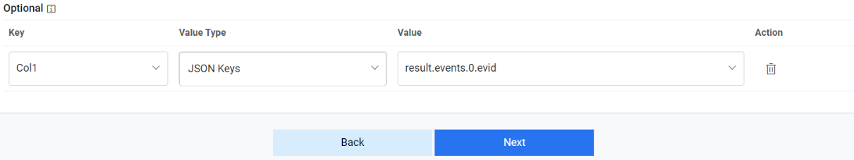

  12. If you need to add Optional parameters, click Add Response Parameter to add more parameters. For our purpose, we will be adding a couple of extra parameters, as mentioned below, as we need them in the later section.
    Sample Optional Parameters
    Col1 JSON.Keys result.0.evid
    Figure 7. Optional Parameter Mapping
    A screenshot of a computer Description automatically generated

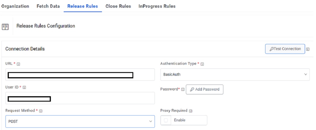

  15. In the Connection Details section, enter the following details:
    1. URL – Type the URL of the selected service type to release the ticket. It contains the placeholders that display the parameters based on the applied clause and is dependent on the URL or API provided by the tool.
      Sample URL https://url.servicenow.com/api/now/v1/table/sc_request?sysparm_fields=#Columns
    2. Authentication Type – Please enter the information in line with the Authentication type configured for fetching data configuration previously.
    3. Request Method – Select Request Method as POST from the drop-down.
    4. Proxy Required – Check Proxy Required, if the environment needs access to content from data sources outside the firewall.
    Figure 8. Release Rules Configuration (Connection Details)

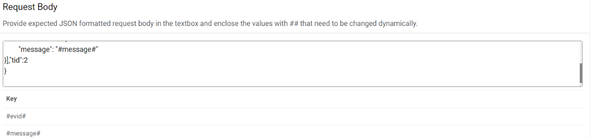

  17. Request Body – In this section, please enter the request body in JSON format. A sample request is mentioned below -
    Request Body –
    "method": "write_log",
    "data": [{
    "evid": "#evid#",
    "message": "#message#"
    }],"tid":2
    Figure 9. Release Rules (Request Body)

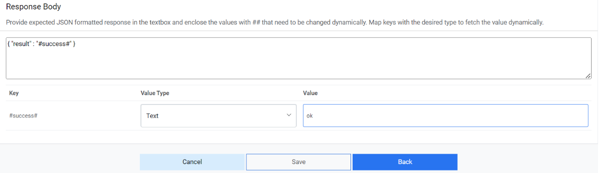

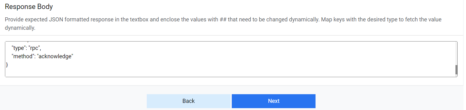

  18. Response Body – In this section, please enter the response body in JSON format. A sample response is mentioned below -
    Response Body –
    "uuid": "xxxxxxxx",
    "result": {
    "success": true
    "tid": 2,
    "type": "rpc",
    Figure 10. Release Rules Configuration (Response Body)

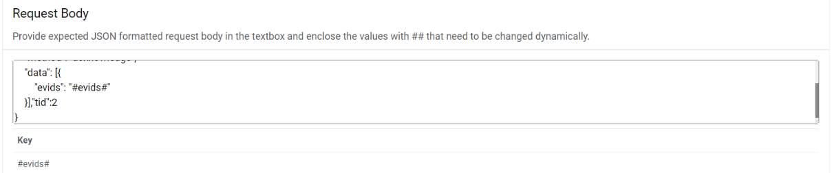

  22. Request Body – In this section, please enter the request body in JSON format. A sample request is mentioned below.
    Request Body –
    "method": "close",
    "data": [{
    "evids": "#evids#"
    }],"tid":2
    Figure 12. Release Rules (Request Body)

    Figure 13. Release Rules Configuration (Response Body)

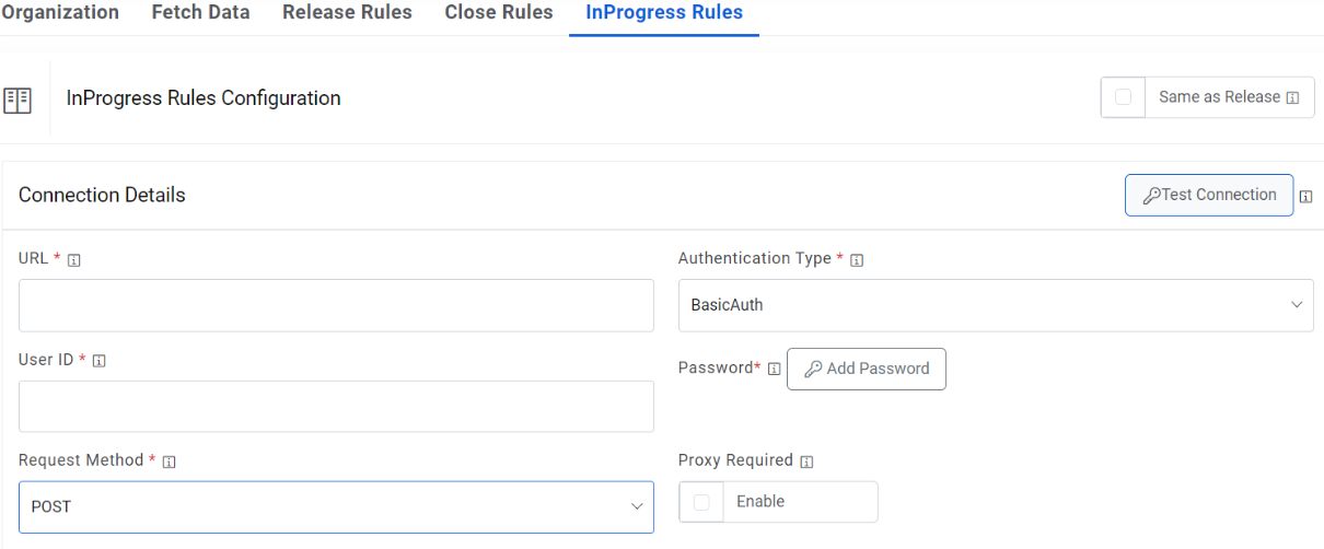

  24. On InProgress Rules tab, type in the details as per the requirement. Check Same as Release if similar configurations as mentioned in “Release Rules Configuration” are required, else proceed ahead.
  25. In the Connection Details section, enter the following details:
    Figure 14. Release Rules (Connection Details)

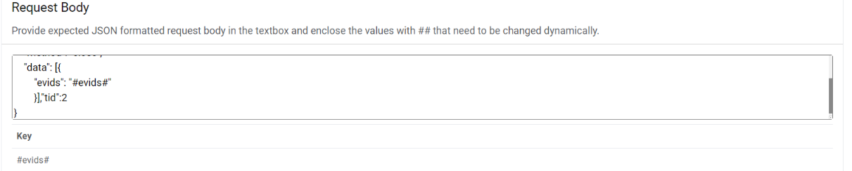

  27. Request Body – In this section, please enter the request body in JSON format. A sample request is mentioned below -
    Request Body –
    "method": "acknowledge",
    "data": [{
    "evids": "#evids#"
    }],"tid":2
    Figure 15. Release Rules Configuration (Request Body)
    A white rectangular object with black letters Description automatically generated with medium confidence

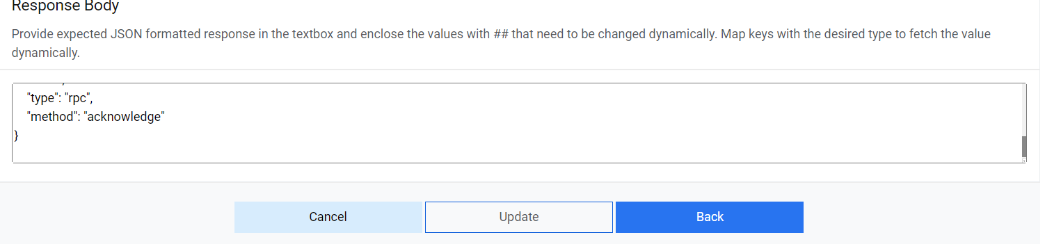

  28. Response Body – In this section, please enter the response body in JSON format. A sample response is mentioned below -
    Response Body –
    "uuid": "xxxxxxxx",
    "result": {
    "data": {
    "updated": 31,
    "total": 3670
    "success": true
    "tid": 2,
    "type": "rpc",
    Figure 16. Release Rules Configuration (Response Body)
