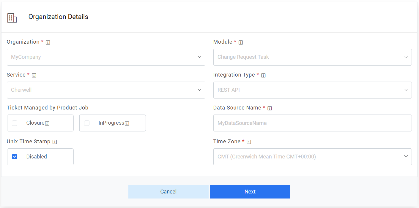

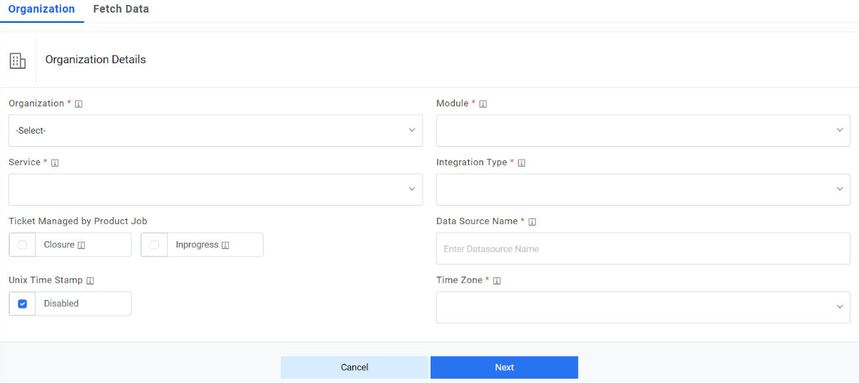

  3. On the Organization tab,
    1. Select the Organization Name from the dropdown.
    2. Select the Module as Change Request Task since we are configuring this data source for pulling the change request task tickets.
    3. Select the Service as Cherwell Tool as we are configuring the data source for Cherwell.
    4. Select the Integration Type as REST, since we will be integrating through REST APIs.
    5. Select the Timezone to specify the time zone of the selected data source.
    6. Select Timestamp to view the present data with date and time.
    7. Click Next.
    Figure 2. Create Data Source (Cont.)

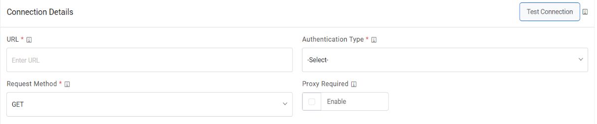

  5. In the Connection Details section, enter the following details:
    1. URL – Type the URL which contains the placeholders that display the parameters based on the applied clause such as the number of records to be fetched, query type, date on which the data is fetched, and the order by and so on. It depends on the URL or API provided by the tool.
      Sample URL
      http://<iAutomate_API_URL>/iAutomateAPI/Request/GetChangeTicketData/<Org_ID>?start_date>=#Start_Date#&end_date<=#End_Date#&
      Here, < iAutomate_API_URL > is the API URL of iAutomate where Push APIs are present and <Org_ID> is the OrgID for the organization for which you are creating the data source. It is available in Organization Master in Database.
    2. Authentication Type – Select one of the Authentication Types from Basic / Windows, OAuth 2.0
      The user details that are entered here should be an API User
      1. Selection of Basic / Windows requires you to enter -
        • User Id
        • Password
      2. Selection of OAuth 2.0 requires you to enter -
        • User Id
        • Password
        • Authentication URL
    3. Request Method - Select GET, POST or PUT as Request Method as per the configured URL
    4. Proxy Required – Check Proxy Required, if the environment needs access to content from data sources outside the firewall.
    5. Click on Test Connection to check accessibility of URL from service. Testing the connection is not mandatory, you can still create Data source.
    Figure 4. Create Data Source (Connection Details)

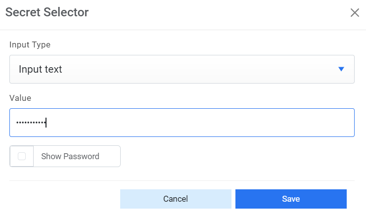

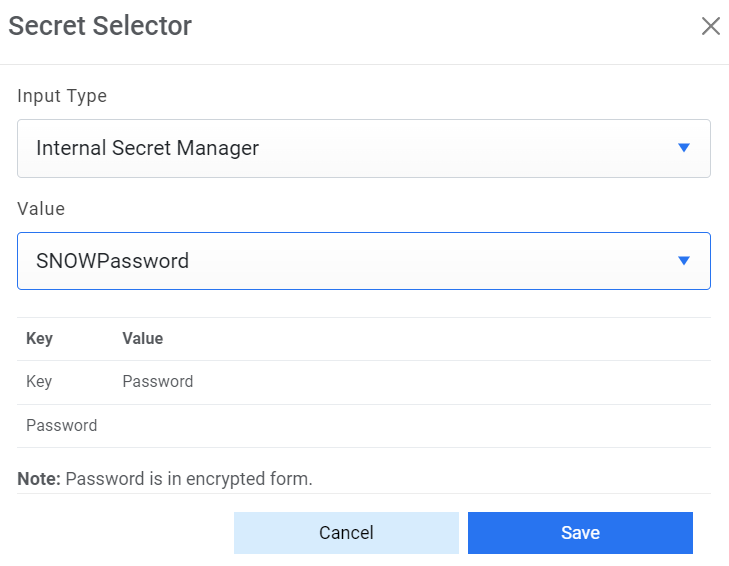

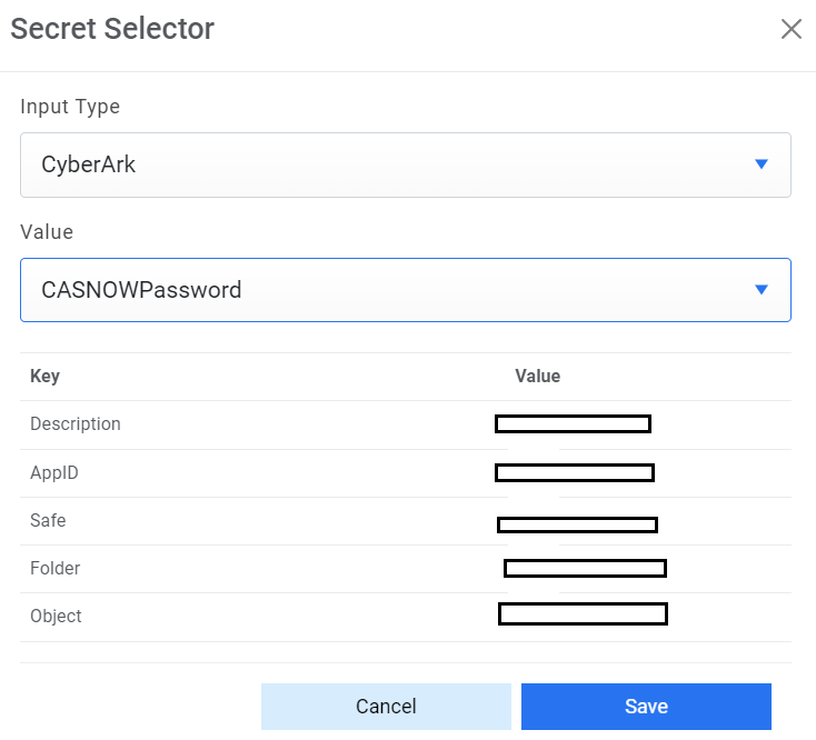

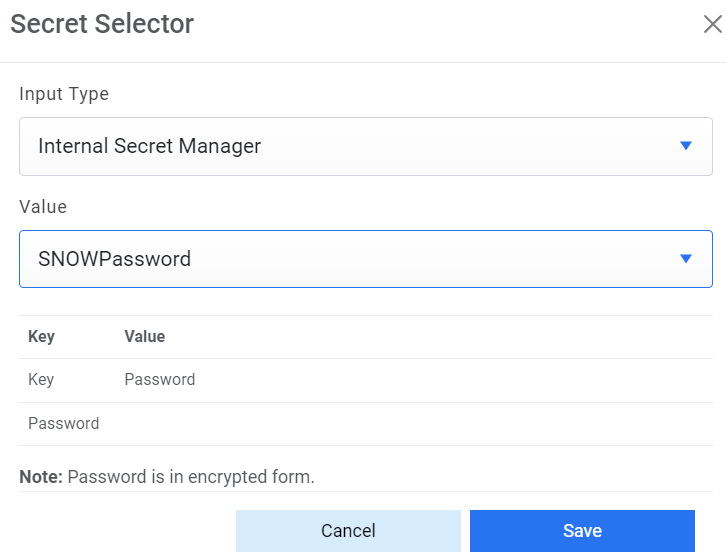

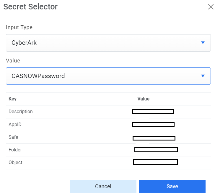

  6. For Password, click on icon next to it. If the password is available in plaintext, then select Input type as Input Text and enter the password in Value field. Else if it is available in Azure Key Vault then select Input Type as Azure Key Vault and then select any of the configured details from the value field. Else if it is available in any Key Vault such as CyberArk or Secret Manager then select Input Type as CyberArk or Secret Manager respectively and then select any of the configured details from the value field.
    Figure 5. Password in Plaintext
    A screenshot of a login page Description automatically generated
    Figure 6. Password from Key Vault (CyberArk)
    A screenshot of a computer Description automatically generated

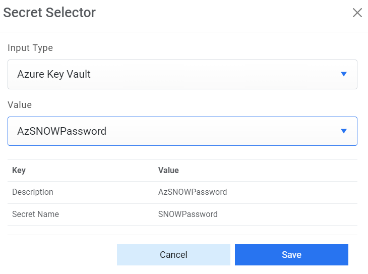

    Figure 7. Password from Secret Manager
    Figure 8. Password from Azure Key Vault

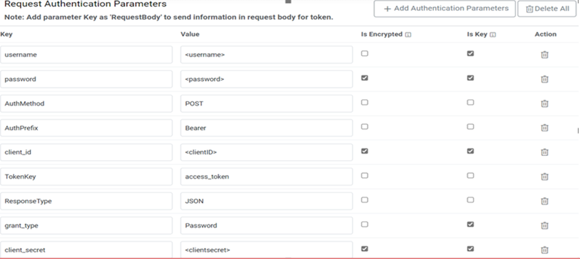

  7. Request Authentication Parameters – If the user has additional parameters, click Add Authentication Parameters under the Request Authentication Parameters tab.
  8. Based on the Authentication Type, add the parameters mentioned in the table below.
    Sample Authentication Parameters
    Authentication Type Key Value Is Encrypted? Is Key?
    OAuth2.0 username <username> NO YES
    OAuth2.0 password <password> YES YES
    OAuth2.0 AuthMethod POST NO NO
    OAuth2.0 AuthPrefix Bearer NO NO
    OAuth2.0 client_id <clientID> YES YES
    OAuth2.0 client_secret <clientsecret> YES YES
    OAuth2.0 TokenKey access_token NO NO
    OAuth2.0 ResponseType JSON NO NO
    OAuth2.0 grant_type Password NO YES
    Figure 9. Create Data Source (Request Authentication Parameters for OAuth2.0)

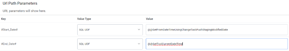

  9. URL Path Parameters – Based on the URL entered earlier, please map the values to the URL Path Parameters. E.g., for the URL entered earlier, please populate the inputs below.
    Key: #StartDate#
    ValueType: SQL UDF
    VALUE: @@GetFromDateTimeUsingChangeTaskPushStagingModifiedDate
    Key: #EndDate#
    ValueType: SQL UDF
    VALUE: @@GetToolCurrentDateTime
    Figure 10. URL Path Parameters

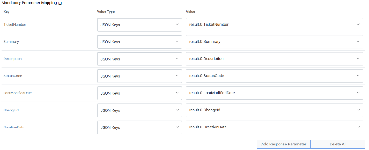

  12. After entering the response, click Extract Keys to add the parameters in the Mandatory Parameter Mapping section.
  13. Mandatory Parameter Mapping – Please map the mandatory parameters to the respective values as mentioned in the screenshot below.
    Sample Mandatory Parameter Mapping
    Key Value Type Value
    TicketNumber JSON.Keys result.0.TicketNumber
    Summary JSON.Keys result.0.Summary
    Description JSON.Keys result.0.Description
    StatusCode JSON.Keys result.0.StatusCode
    LastModifiedDate JSON.Keys result.0.LastModifiedDate
    ChangeId JSON.Keys result.0.ChangeId
    CreationDate JSON.Keys result.0.CreationDate
    Figure 11. Mandatory Parameter Mapping

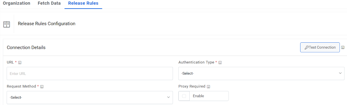

  16. On Release Rules tab, type in the details as per the requirement.
  17. In the Connection Details section, enter the following details:
    1. URL – Type the URL of the selected service type to release the ticket. It contains the placeholders that display the parameters based on the applied clause and is dependent on the URL or API provided by the tool.
      Sample URL - https://<url>. cherwellondemand.com/CherwellAPI/api/V1/sample
    2. Authentication Type – Please enter the information in line with the Authentication type configured for fetching data configuration previously.
    3. Request Method – Select Request Method as POST from the drop-down.
  18. Click on Test Connection to check accessibility of URL from service. Testing the connection is not mandatory, you can still create Data source.
    Figure 13. Release Rules (Connection Details)

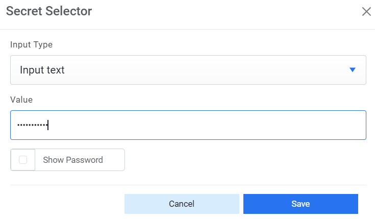

  19. For Password, click on icon next to it. If the password is available in plaintext, then select Input type as Input Text and enter the password in Value field. Else if it is available in Azure Key Vault then select Input Type as Azure Key Vault and then select any of the configured details from the value field. Else if it is available in any Key Vault such as CyberArk or Secret Manager then select Input Type as CyberArk or Secret Manager respectively and then select any of the configured details from the value field.
    Figure 14. Password in Plaintext

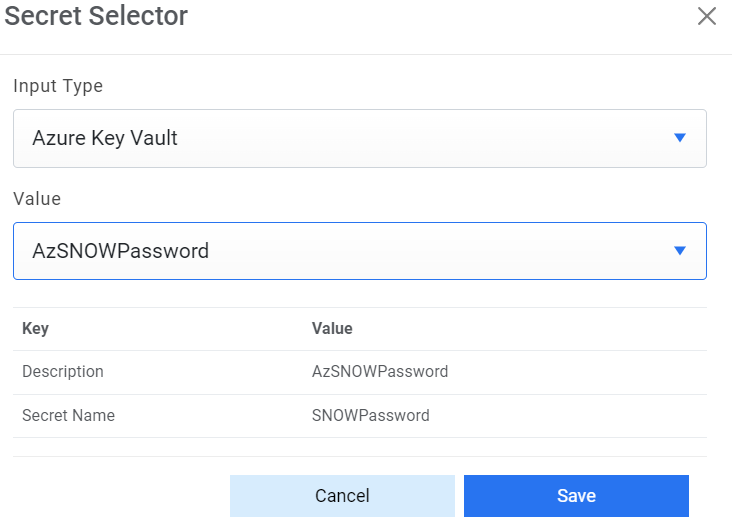

    Figure 17. Password from Azure Key Vault

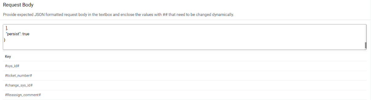

  22. Request Body - In this section, please enter the request body in JSON format. A sample request is mentioned below:
    Request Body –
    "busObId": "946004f5f680a57b6747774eda9a6fa2f5d0e73db1",
    "cacheScope": "Tenant",
    "fields": [
    "dirty": true,
    "displayName": "Task RecID",
    "fieldId": "946005353974025498ed1d4068936d72c8992d015c",
    "value": "#sys_id#"
    "dirty": true,
    "displayName": "Ticket Number",
    "fieldId": "94602e208e8947bff420df4016b30962152556d5e2",
    "value": "#ticket_number#"
    "dirty": true,
    "displayName": "Parent RecID",
    "fieldId": "9460053dd53d9888efddc34d3db0360cc5be25f567",
    "value": "#change_sys_id#"
    "dirty": true,
    "displayName": "Journal Details",
    "fieldId": "946005008899c5f5c31caa43c99083519668f0ff33",
    "value": "#Reassign_comment#"
    "dirty": true,
    "displayName": "Assignment Team",
    "fieldId": "946005013472134fdc1b0649a685d41a4c73f6e179",
    "value": "GBP Change Management"
    "dirty": true,
    "displayName": "Status",
    "fieldId": "946004ff47672c8cda67da43a1945ce56f2f617855",
    "value": "Acknowledged"
    "dirty": true,
    "displayName": "Task Type",
    "fieldId": "946004feb10853e55a192849c780773b2133028cc0",
    "value": "Change Task"
    "dirty": true,
    "displayName": "Reassigning",
    "fieldId": "946005a199ecde0a9cf0b748bb94e4040c2007540f",
    "value": "True"
    "persist": true
    Figure 19. Release Rules (Request Body)

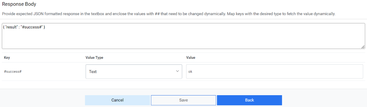

  23. Response Body – In this section, please enter the response body in JSON format. A sample request is mentioned below.
    Response Body –
    { "result" : "#success#" }
    Figure 20. Release Rules (Response Body)

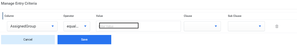

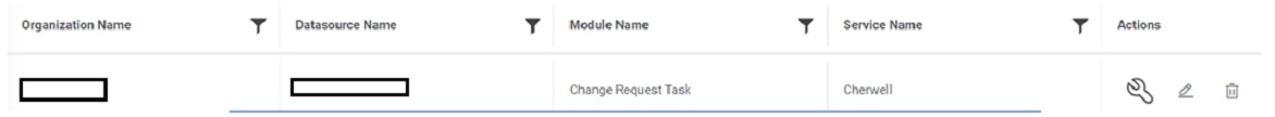

  26. To bring the tickets within iAutomate scope, a specific queue needs to be configured in the ITSM tool and same has to be configured in iAutomate. This is achieved through Manage the Entry Criteria. Please follow the following steps:
    1. Go to the Actions tab and click Manage Data Sources.
    2. On the Data Sources tab, click next to the data source user wants to manage. Manage Entry Criteria screen appears.
      Figure 21. Manage Entry Criteria
    3. Select ‘AssignedGroup’ for the Column field and ‘equals to’ for the Operator field.
    4. Enter the sys_id of the assignment group in Cherwell in the Value field.
    5. Clause and Sub-Clause fields can also be added based on requirement.
    Figure 22. Manage Entry Criteria (Cont.)

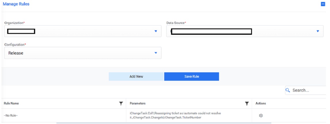

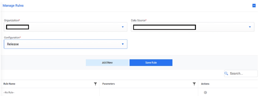

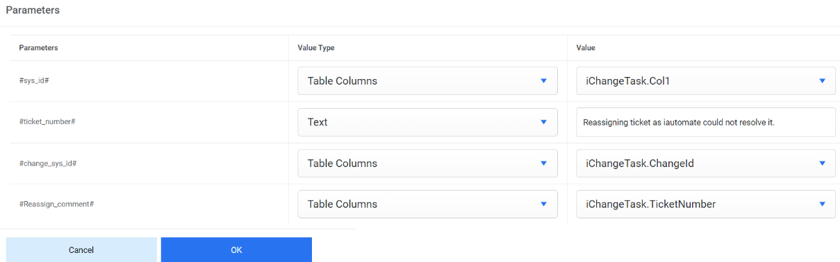

  28. To configure the Release rules for the data source created earlier, perform the below steps:
    1. Go to Runbooks and click Manage Rules.
    2. Select the Organization and the data source created from Data Source dropdown.
      Figure 23. Manage Release Rules
    3. Click on corresponding to –No Rule—.
    4. Map the parameters #sys_id# to the column in which sys_id was mapped while performing the mandatory parameter mapping while data source creation.
    5. Mention the reason for releasing ticket in #reassign_comments#.
    6. Map #change_sys_id # again to the column in which ChangeId was mapped while performing the mandatory parameter mapping while data source creation.
    Figure 24. Manage Release Rules (Cont.)
  29. Click OK.
    Figure 25. Manage Release Rules (Cont.)
  30. Click Save Rule.
