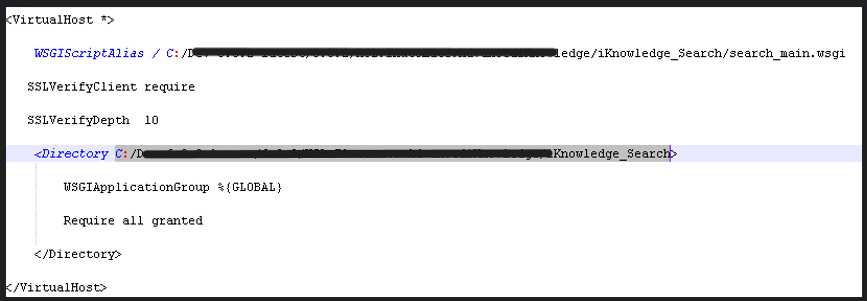

At the bottom of iKnowledgeSearch.conf file you will find the path to the
python files as highlighted in the below figure. Figure 1. HCL.iAutomate.iKnowledgeSearch (cont.)

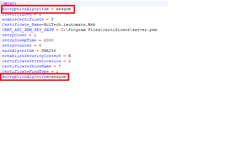

Open the file IKNOWLEDGE_SEARCH.cfg from the location
<highlighted_path_in_fig_128> and search for any duplicate keys
present in the file. You can refer below keys for reference: Figure 2. HCL.iAutomate.iKnowledgeSearch (cont.)
Remove the last entry that is duplicate for each key. In the
above case delete the second entry of EncryptionAlgorithm =
aesgcm. Similarly check for any other duplicate keys and
remove the last entry and save the file.
