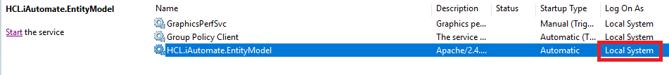

Ensure that service was created through Service Account and not through Local
account. Refer to the figure below to check the status. Figure 1. HCL.iAutomate.EntityModel service is not starting
If not, open Windows Command Prompt in Administrator mode and run the
below
command:
sc config HCL.iAutomate.EntityModel obj= “ID” password= “PSWD”where ID is the [Domain\SA ID] and PSWD is the [Password of SA] and SA is [Service Account].
‘Log On As’ field corresponding to the service
HCL.iAutomate.EntityModel should be changed to ‘Service Account’.
Click Start to start the service.
