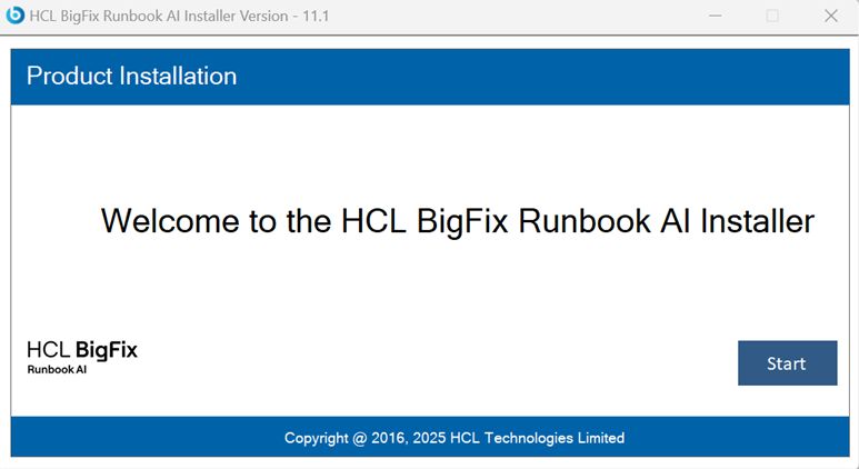

  1. On running the Installer, the following page appears.
    Figure 1. BigFix Runbook AI Implementation

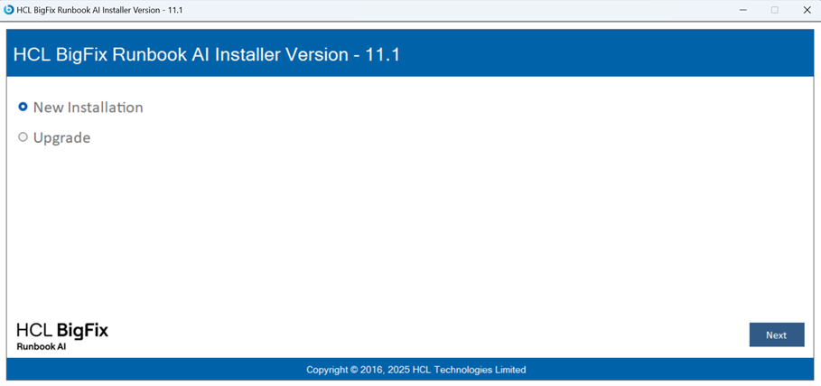

  2. Click Start. It will extract required binaries and the following page appears.
    Figure 2. BigFix Runbook AI Implementation
  3. Click Next. The page lists the setup required for installation in the left pane and the details of the selected setup in the right pane.
