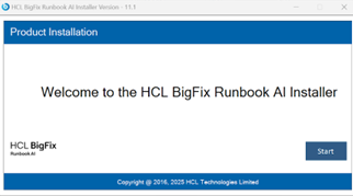

  1. To install the required components on AI server, locate HCL_BigFix Runbook AI_v6.4.1_Installer.exe and click Run as Administrator to begin the installation. On running the installer, the following page appears.
    Figure 1. Run as Administrator
  2. Click Start. It will extract required binaries; the following page appears.
    Figure 2. BigFix Runbook AI Installation

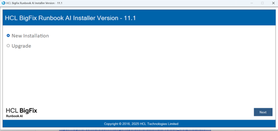

  3. Click Next.
    The page lists the setup required for installation in the left pane and the details of the selected setup in the right pane.
