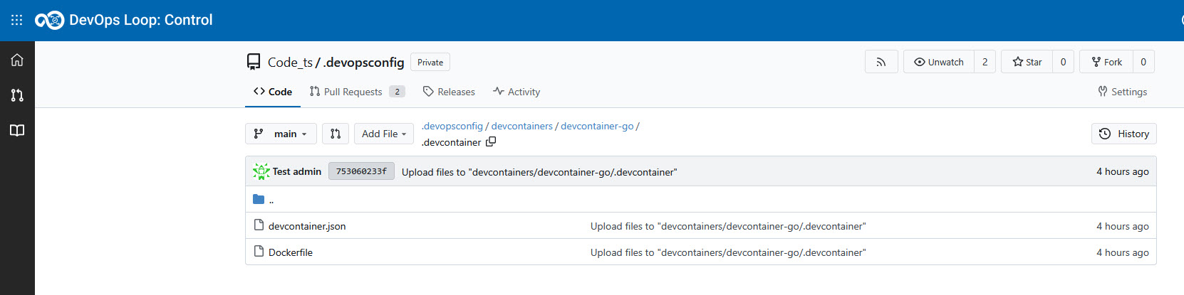

  7. Access Control:
    1. Sign in to HCL DevOps Loop. Navigate to your teamspace.
    2. Go to the Control page. You’ll see a repository named .devopsconfig under your teamspace (e.g., TeamspaceEG/.devopsconfig).
  8. Upload devcontainer.json and Dockerfile using Control:
    1. Inside the .devcontainer folder of the repo, upload devcontainer.json and Dockerfile.
    2. Commit and push the changes to the main branch.
      Note: You can also commit the changes to a different branch other than the main branch. In such a case, you will see different branches on the Branch menu.

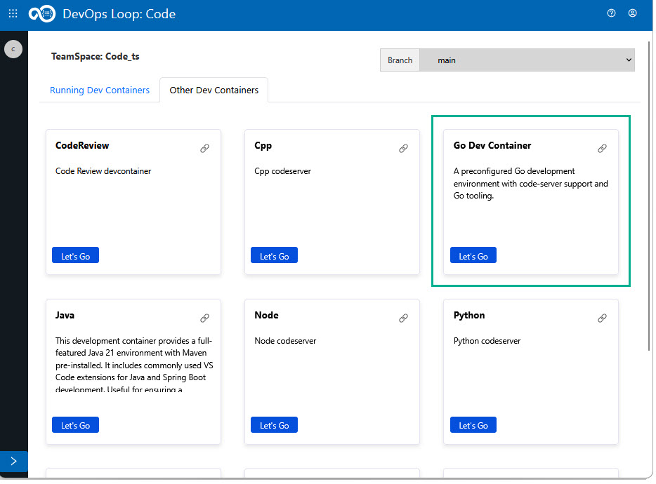

  9. Start the sample Go container:
    1. Go to the Code landing page.
    2. Click the teamspace button and switch to your teamspace. Under Other Dev Containers, you will see a new dev container:
    3. Click Let’s Go to launch the container.
    Note: The first-time launch may take a few minutes.

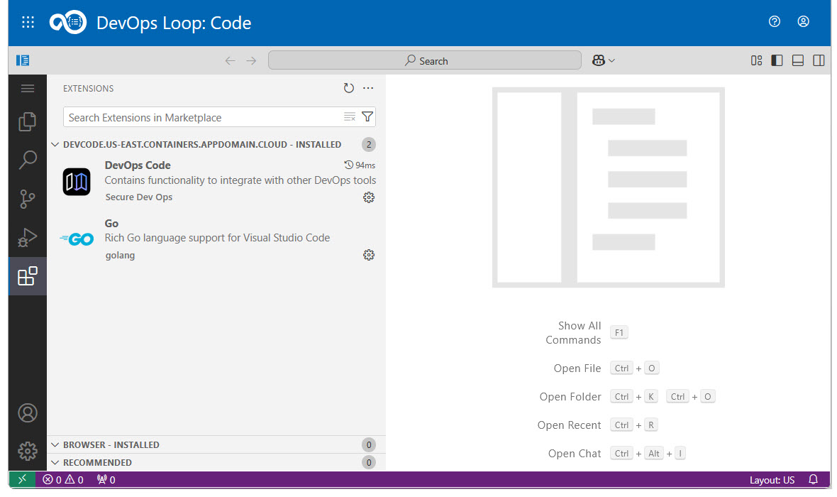

  10. View Visual Studio Code Extensions:
    In the Code IDE instance, click the Extensions button to see and verify the extensions you had configured in devcontainer.json file.

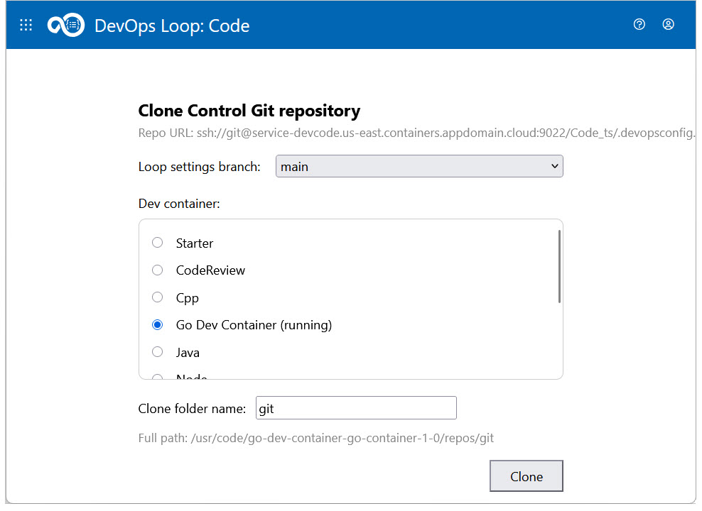

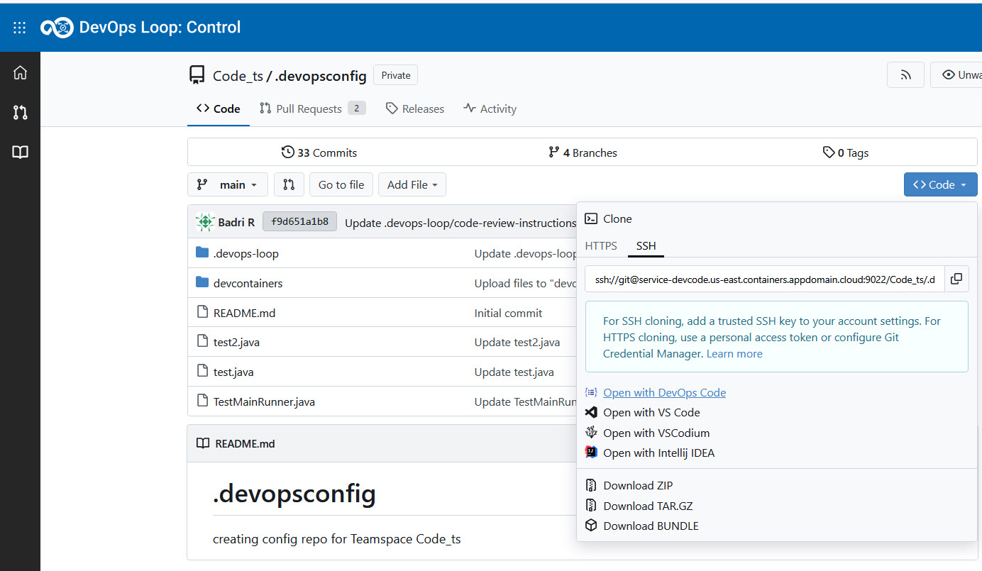

  11. Cloning .devopsconfig repo using DevOps Code:
    After navigating to the Control page and locating the .devopsconfig repository, you can update your configuration files using the recommended workflow
    This method is recommended for making multiple changes, as it provides an easier user experience by leveraging the Git functionality within Code.
    1. Click the Code dropdown button next to the repository name, and select Open with DevOps Code.
    2. This directs to the Clone Control git repository page. Here, add the Loop settings branch, Dev container and a suitable folder name for cloning. You can see how the full path changes according to the name you updated in the Clone folder name textbox.
    3. Click Clone to clone the repository. This directs to Code IDE instance. After successful loading of the IDE page, you get a Clone succeeded at location message popup. Copy the location.
    4. In the Code IDE instance, go to the hamburger menu, select File and click Open Folder, and paste the location path in the Go to file dropdown textbox, and click the OK button.
    5. Navigate to the devcontainer folder in the left Explorer pane, add/update your devcontainer.json and Dockerfile files, and use the built-in Git tools within Code to commit and push the changes to the desired branch of Control.
