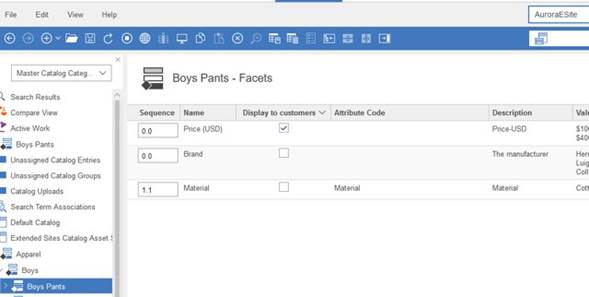

Facets
In the Commerce Lab, the displayable attributes and sequence of a facet can be overriden at the eSite level. In the eSite Store index model, displayable and sequence variables have a single value for that eSite .
                    "facet": [
                            "sequence": 1.1,
                            "search": true,
                            "display": {
                                "zero": false,
                                "limit": 20,
                                "multiple": true,
                                "order": 1
                            "displayable": false,
In the Asset Store index model, displayable and sequence variables list values for all eSite stores.
In the following example, the Boys Pants’s Material facet is not displayable to customers and the sequence is 1.1 in the AuroraESite store.
In the Index, the facet's value for the AuroraESite store (1) is false (“1”: false) and the sequence is 1.1 (“1”: 1.1):
                            "sequence": {
                                "22": 0.0,
                                "1": 1.1,
                                "12": 0.0,
                                "2": 0.0,
                                "32": 0.0
                            "search": true,
                            "display": {
                                "zero": false,
                                "limit": -1,
                                "multiple": false,
                                "order": 0
                            "displayable": {
                                "22": true,
                                "1": false,
                                "12": true,
                                "2": true,
                                "32": true
                            "id": "3074457345618268605",
                            "attribute": {
                                "identifier": "Material",
                                "name": "Material",
                                "ribbon": false,
                                "id": "7000000000000000009",
                                "swatchable": false
Product Schema
