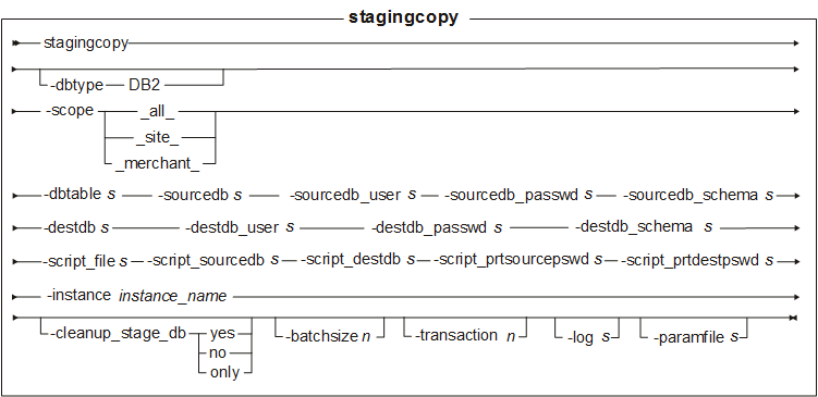

The stagingcopy utility copies data from the production database to the production-ready data on a staging or authoring environment.
Important:
  • Your staging and production environments must be at the same maintenance level to successfully run the stagingprop utility.
  • OracleIf Archive Logging is enabled, running the stagingcopy utility can result in a non-linear increase in the amount of disk space that is used by the destination database. The amount of disk space that is used by the Archive Logs can be up to 4 - 8 times the final size of the destination database. Ensure that you monitor your file system size to avoid running out of disk space for the destination database.
stagingcopy utility syntax diagram.
