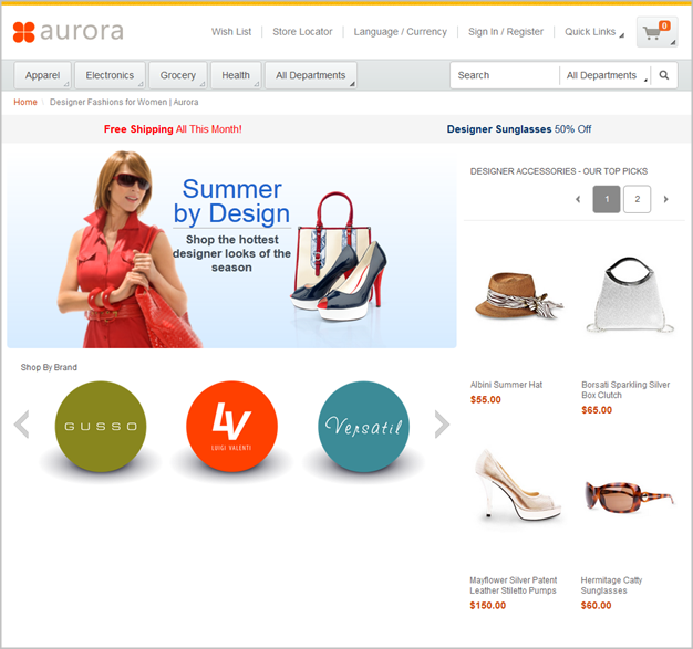

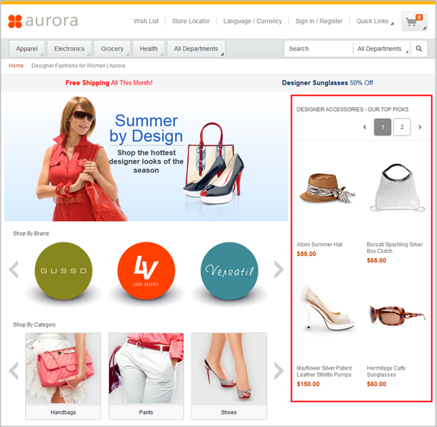

- Click the row that contains WBG007_0622. Then, click the up arrow above the table to move this product to the second position in the list.
- Click Save and Preview. Your layout now has product recommendations in the right sidebar:
