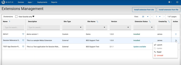

Uninstalling an extension
You can uninstall an extension that is no longer needed.
To uninstall an extension complete the following steps:
  1. From the Extension management page, click the drop-down menu corresponding to an extension that you want to uninstall and from the menu, select Uninstall.

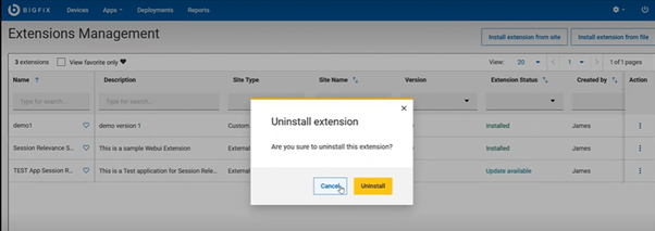

  2. In the pop-up window, click Uninstall to confirm uninstalling.
    If you are uninstalling an extension from a custom site, you can also remove the extension file uploaded to that site.
