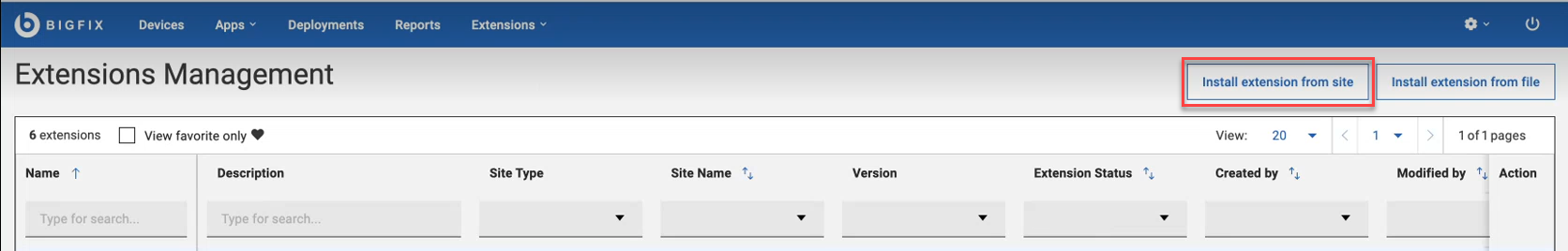

  2. From the menu bar click settings and select Extensions Management.
  3. On the Extension Management page, click Install extension from site.

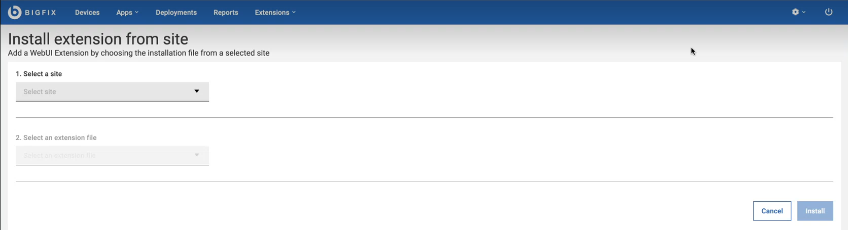

  4. The following page appears.
    From the drop-down:
    1. Select a site in which the extension file is available.
      You can view only the sites that you have access to.
    2. Select an extension file. You can view all the extensions that are published to the selected site.
  5. Click Install.
