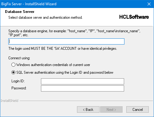

  2. If you chose Local Database, skip this step. In the Database Server dialog, enter the hostname or IP address of the computer that will host your secondary server's database, and the credentials of an account with sysadmin permissions on the database instance. Consider that, if you choose Windows authentication, you will have to use the same user to access the primary server's database.

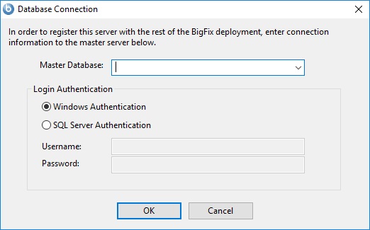

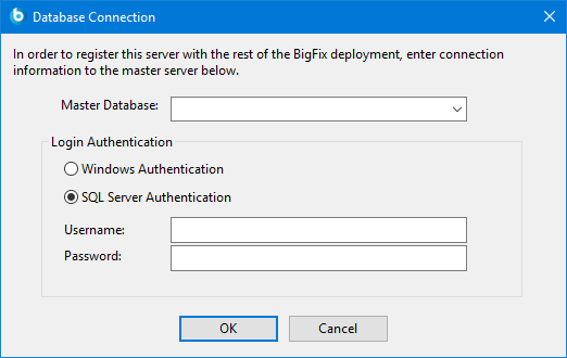

  3. Proceed through the dialogs until the installation operations begin. At one point during the setup process, the Database Connection dialog will pop up. Enter the hostname or IP address of the computer hosting the database of your primary server. If you chose the Local Database option for the secondary server's database, you must use SQL Server authentication to access the primary server's database. If you chose to access the secondary server's database using Windows authentication, you will have to use the same user to access the primary server's database.

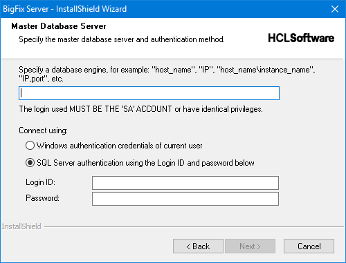

  1. In the Master Database Server dialog, enter the hostname or IP address of the computer hosting the database of your primary server's database, and the credentials of an account with db_owner permissions on the BFEnterprise database. If you choose Windows authentication, you will have to use the same user to access the secondary server's database.

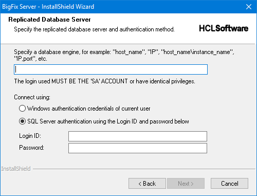

  2. In the Replicated Database Server dialog, enter the hostname or IP address of the computer that will host your secondary server's database, and the credentials of an account with sysadmin permissions on the database instance.
