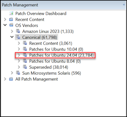

In the Patch Management domain, click OS Vendors from the navigation tree and click Canonical.

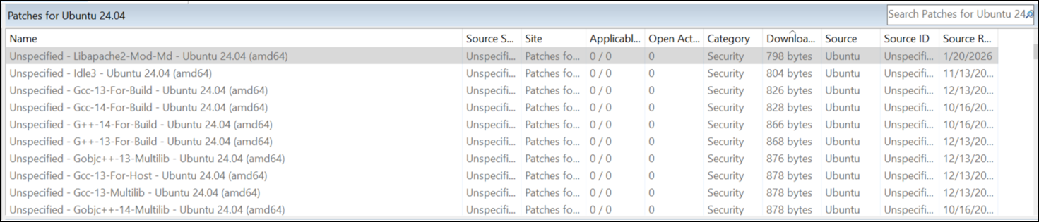

The navigation tree expands. Select the correct version of Patches for Ubuntu.

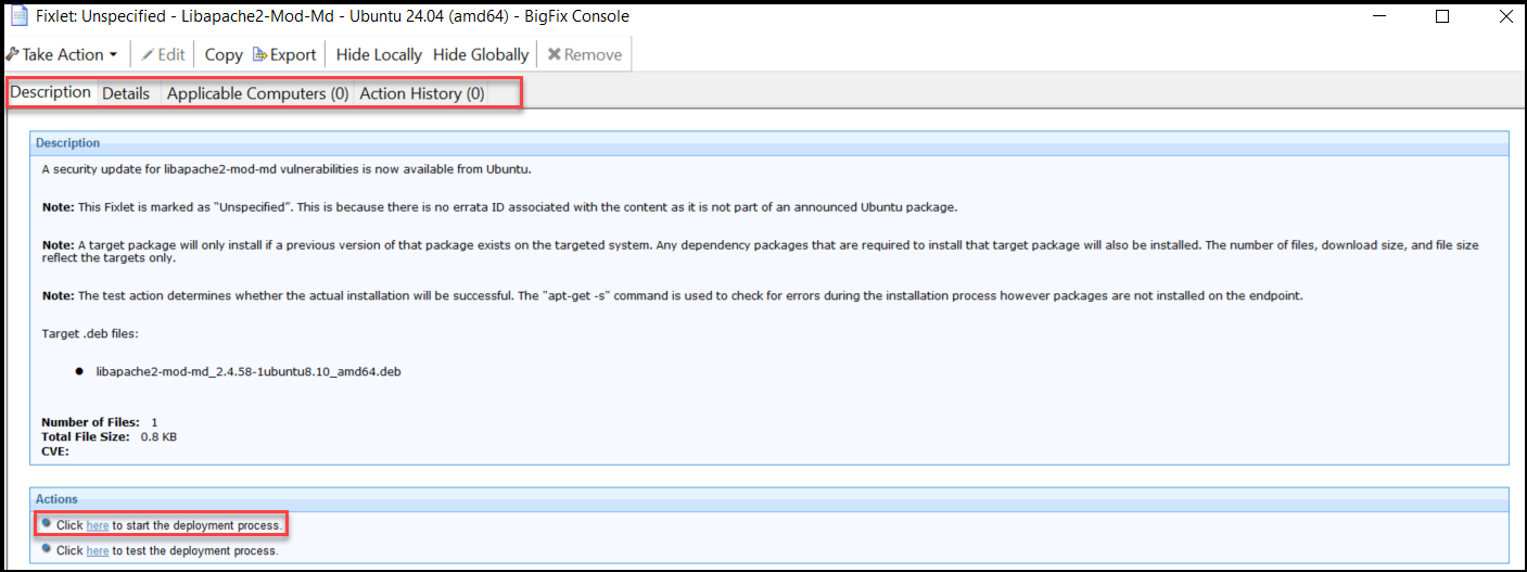

From the list panel on the right, double-click the Fixlet that you want to deploy.
The Fixlet opens in the work area. Click the tabs at the top of the window to review details about the selected Fixlet.
Click the link in the Actions box to start the deployment. The Ubuntu website opens to display the package information and links to download files.
