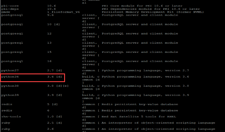

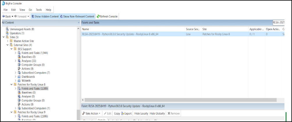

    Perform the following steps to deploy the modular Fixlet "RLSA-2025:8419 - Python36:3.6 Security Update - RockyLinux 8 x86_64":
    1. The Fixlet "RLSA-2025:8419 - Python36:3.6 Security Update - RockyLinux 8 x86_64" is not applicable because python36 version of 3.6 is not enabled on the endpoint as shown in the following figures:
      Figure 1. Python36 Fixlet
      Python36 Fixlet
      Figure 2. Python 3.6 (disabled)

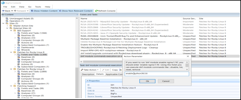

    2. To enable python modular stream version of 3.6, you must deploy the Fixlet "501 dnf module commands execution on endpoint - RockyLinux 8 - x86_64" as shown in the following figures:
      Figure 3. Enable python36 module with stream 3.6

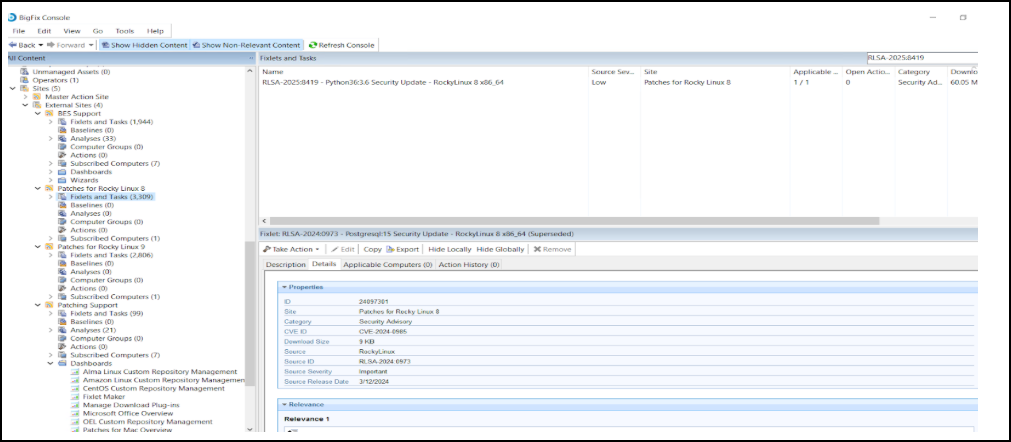

    3. The Modular Fixlet "RLSA-2025:8419 - Python36:3.6 Security Update - RockyLinux 8 x86_64" become relevant on the client after python36 3.6 has been enabled, as shown in the following figure:
      Figure 4. Relevant Fixlet
    4. Now, modular Fixlet "RLSA-2025:8419 - Python36:3.6 Security Update - RockyLinux 8 x86_64" is applicable and can be deployed on the client.
