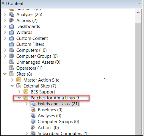

  1. From the Patch Management domain, click OS Vendors > Alma Linux, and navigate to the patch content using the domain nodes.
    Figure 1. Patch Management navigation tree

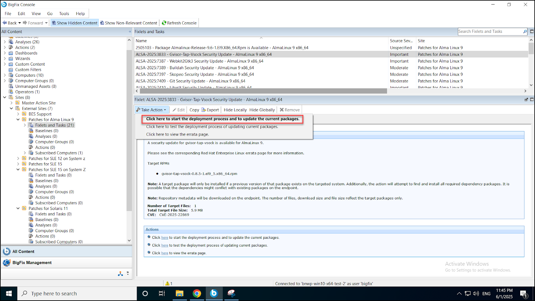

  2. In the content that is displayed in the list panel, select the Fixlet that you want to deploy. The Fixlet opens in the work area.
  3. Click the tabs at the top of the window to review details about the Fixlet.
  4. Click Take Action to deploy the Fixlet.
    You can also click the appropriate link in the Actions list:
    • You can start the deployment process.

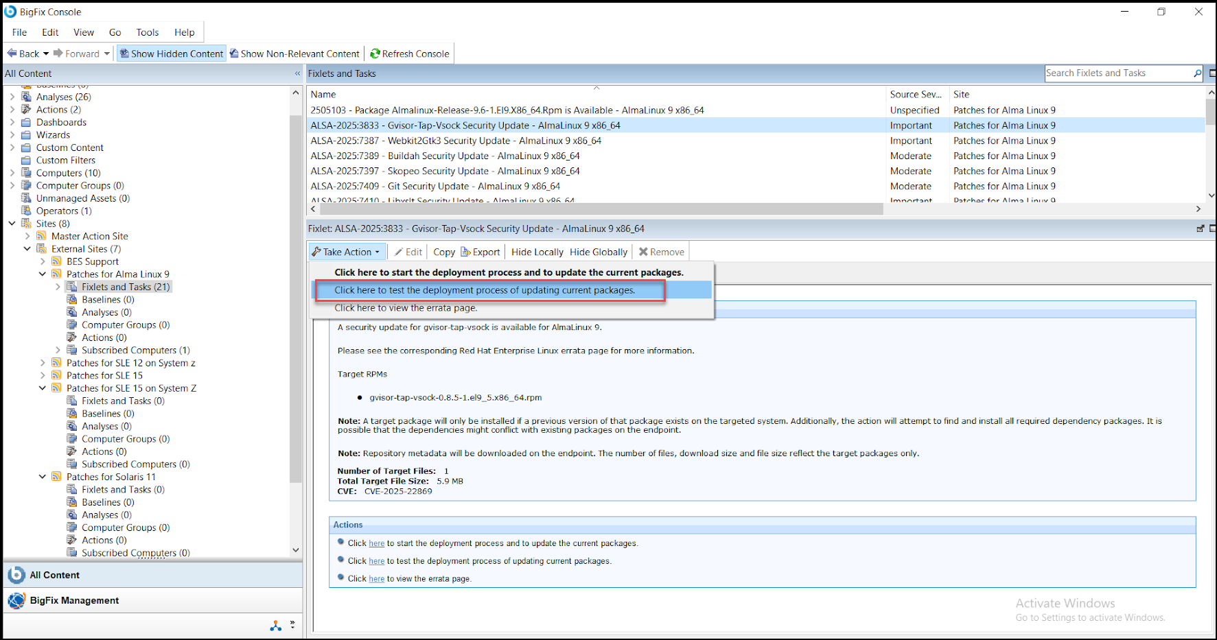

    • You can deploy a test run prior to applying the patch. View the Endpoint Dependency Resolution - Deployment Results analysis to determine if the dependencies have been successfully resolved and if an installation is successful.
      Figure 3. Take action to deploy a test
