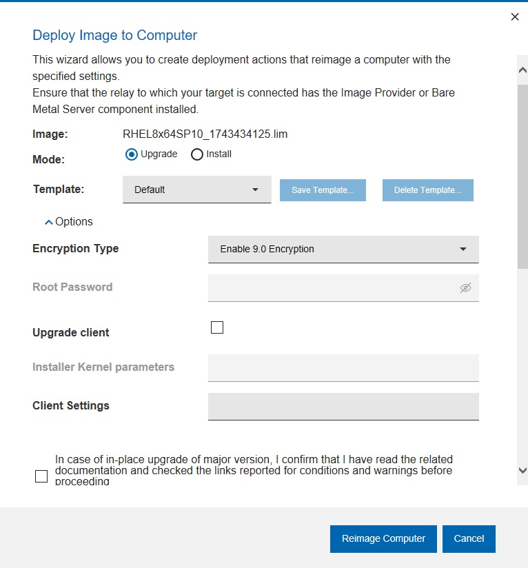

Reimaging in Upgrade mode
In the Deploy Image to Computer dialog, select Upgrade.
Deploying image to computer dialog - upgrade mode
Apart from specific upgrade paths for RHEL (RHEL in-place upgrade, that is described in the next section), this mode is intended for upgrading to later service packs for the same major release. However, if you check Force upgrade, when it's available, the upgrade to a major release is forced, which could lead to an unsuccessful deployment. If you plan to change major release, you should use the install mode.
There are no required parameters for the Upgrade mode if it's not a RHEL in-place upgrade. Optionally, you can select to upgrade the BigFix client, by checking the corresponding option. You are then prompted to select the client package version. All selections that you make must be saved to a template. You can save to the Default template, choose to save your selections to a new template, or populate the dialog with settings from a previously saved template. The default configuration parameters that are stored in the installer response file and used for the upgrade are displayed. You can modify these parameters to suit your reimaging needs. Optionally, you can specify additional kernel parameters that the Linux installer uses during installation, and any client settings for the targets.
RHEL in-place Upgrade
Reimaging in Upgrade mode can be used on RHEL, for some specific paths, to upgrade to major release. The supported upgrade paths for RHEL in-place upgrade are from RHEL Server version 7.9 to 8.8 and 8.10, from RHEL version 8.8 to 9.2, from RHEL version 8.9 to 9.3, from RHEL version 8.10 to 9.4 or later, from RHEL version 9.6 to 10.0, and from RHEL version 9.7 to 10.1. Before proceeding with the in-place upgrade, you need to verify the conditions and warnings at the following links for the respective in-place upgrades:
The creation of an in-place upgrade OS resource for the specific initial OS is needed before proceeding with the task. More details are available at this link - https://help.hcl-software.com/bigfix/10.0/lifecycle/Lifecycle/OSD_Users_Guide/c_manage_linux_dep_media.html. You must accept the disclaimer that you consulted this documentation and the Red Hat documentation for instructions and warnings for the in-place upgrade in order to unblock the in-place upgrade task (assessment only or actual upgrade).
After accepting the disclaimer, you have the following different options that can be selected:
