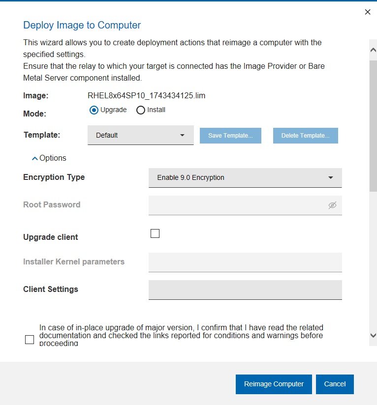

Reimaging in Upgrade mode
In the Deploy Image to Computer dialog, select Upgrade.
Deploying image to computer dialog - upgrade mode
Apart from specific upgrade paths for RHEL (RHEL in-place upgrade, that is described in the next section), this mode is intended for upgrading to later service packs for the same major release. However, if you check Force upgrade, when it's available, the upgrade to a major release is forced, which could lead to an unsuccessful deployment. If you plan to change major release, you should use the install mode.
There are no required parameters for the Upgrade mode if it's not a RHEL in-place upgrade. Optionally, you can select to upgrade the BigFix client, by checking the corresponding option. You are then prompted to select the client package version. All selections that you make must be saved to a template. You can save to the Default template, choose to save your selections to a new template, or populate the dialog with settings from a previously saved template. The default configuration parameters that are stored in the installer response file and used for the upgrade are displayed. You can modify these parameters to suit your reimaging needs. Optionally, you can specify additional kernel parameters that the Linux installer uses during installation, and any client settings for the targets.
