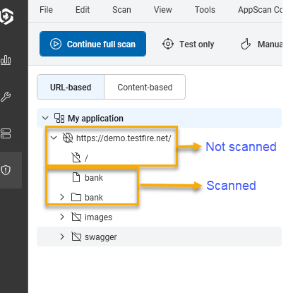

When the scan starts and the Application Tree fills in the left pane, links to parts of the application that are not below the Starting URL are shown with a backslash (\), indicating that they were not scanned.
Backslash (\) icon in application tree indicating not scanned URLs
