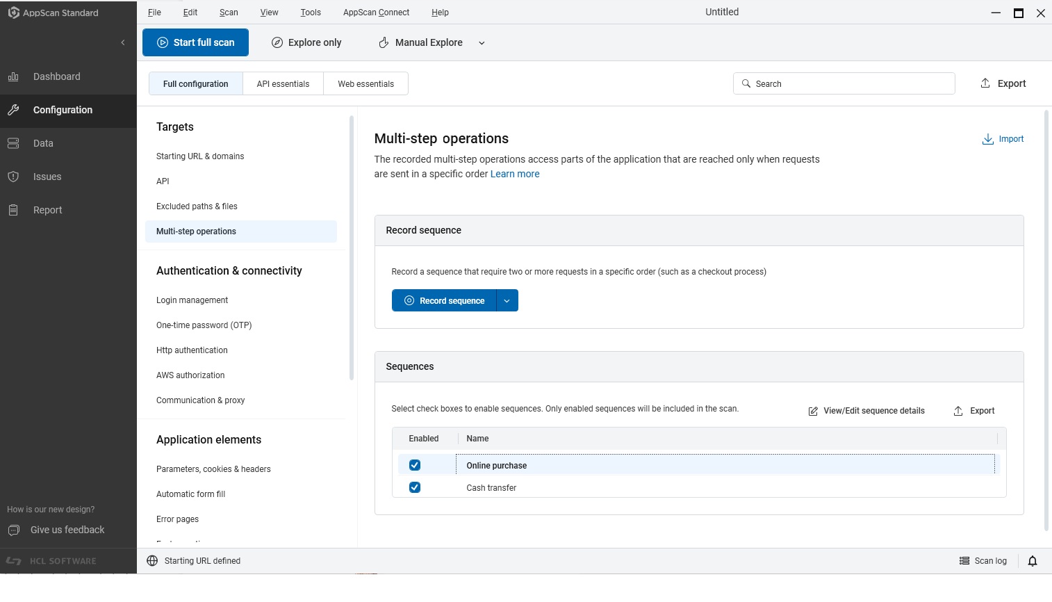

Sequences
Record sequence
Click to record a new sequence. If you have configured login details, you can click the down arrow to select them. For more information, see Record sequence with browser.
Playback method
When you record a multi-step operation, AppScan records both the actions and the requests. You can select which of them will be used for the scan:
Request-based playback
Sends the raw HTTP requests from the recording. This method is usually faster.
Action-based playback
Replays the clicks and keystrokes of the user. Reasons for selecting this method could be that the site includes a lot of JavaScript, or that some of the requests in the request-based playback were marked with a red X when you attempted to validate them. This method can increase scan time.
Request-based playback is the default method.
If you load a sequence that was recorded in a version of AppScan that did not support action-based playback, request-based playback is used for that sequence, even if action-based playback is selected.
If you select Action-based playback for a multi-step operation, you must also select Action-based as the login method. If necessary, record the Login sequence again (see Login management).
If you encounter recording issues, disable action-based recording by setting Gui.RecordUserActionsInExternalBrowser to False under Tools > Options > Advanced, then try again.
Import
Import a sequence (SEQ file) exported from a different scan.
Export
Export the selected sequence as a SEQ file to use in a different scan.
Sequence list
Lists all recorded multi-step operations for this scan.
Sequence name
The name of the sequence that is selected in the List of Sequences. The check box next to each one indicates if the sequence is enabled for this scan.
