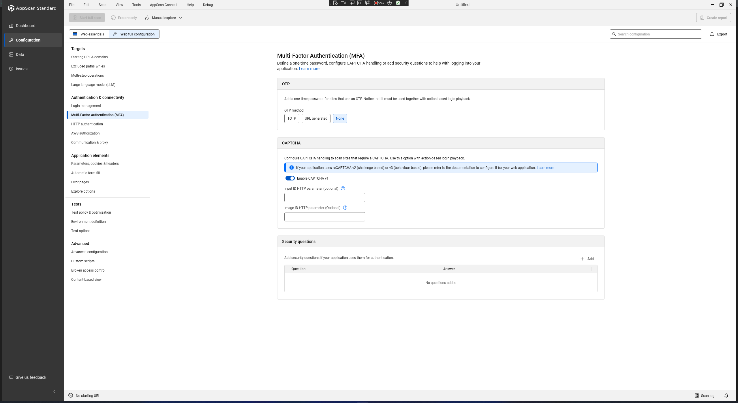

One Time Password (OTP)
If your application uses OTP, select one of the two options, otherwise leave the default setting: None.
When you record the login procedure, AppScan will extract the relevant parameters from the traffic and add them to the OTP HTTP-parameters list. They will also be added to the OTP entry in Automatic Form Fill view. If AppScan fails to identify the parameters, you must add them yourself, either in this view or in Automatic Form Fill view.
Limitations:
  • Only one OTP type (TOTP or URL-generated) is supported per scan.
  • For TOTP only numerical values are supported.
  • When OTP is configured, Action-based must be the selected Login playback method in the Login playback. OTP will not work with Request-based login.

Security questions
"Security questions" is a common method used by applications and websites to add an additional layer of security to user accounts. These questions are typically personal and require users to provide specific answers that only they should know. This extra step helps verify the user's identity, especially during password recovery or when accessing sensitive information.
If your application uses security questions for user authentication, it's essential to add them here. This enables AppScan to accurately identify and capture the security questions during the login recording, in-session detection, or login playback process.
To add security questions:
  1. Click + Add.
  2. Type in the question exactly as defined in your application.
  3. Type in the answer exactly as defined in your application.
  4. Optionally define the parameter.
  5. Click Apply.
Ensure to include all security questions and answers used by your application. Failure to do so might lead to complications when scanning, recording logins, and accessing sensitive information using AppScan.
When you record login (with answer to question) or start the scan, AppScan will identify the security questions in the application during login or the scanning process after a successful login.
