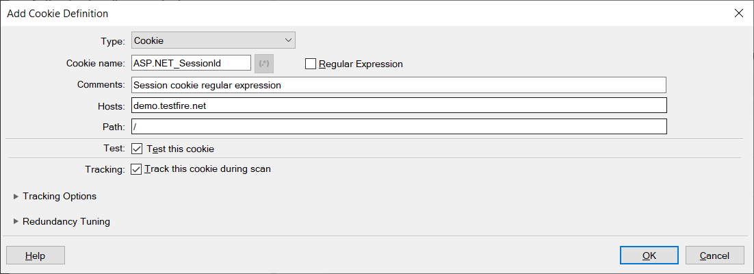

  1. To add a new definition, click +Add.
    The Add Parameter Definition dialog box appears.
    Add Cookie definition dialog box
    Setting
    Description
    Type
    Select a parameter type from the drop-down list:
    Parameter: All parameters matching this name are included in the definition.
    Cookie: All cookies matching this name are included in the definition.
    Custom Parameter: This is a custom parameter (select one of the custom parameters from the Name drop-down list)
    Header: All headers matching this name are included in the definition.
    Name
    The name of the parameter, cookie or header.
    Select the adjacent check box if the name you enter is a regular expression. If you do this you can also open the Expression Test PowerTool by clicking the Regular Expression button, to help you verify the syntax of your regular expression.
    See Parameter names for details.
    Comments
    You may optionally add a comment about the parameter in this field for your own reference.
    Hosts
    If a Host is specified: Use this parameter for the specified host only.
    If left blank: Use this session ID for all hosts.
    Path
    If the application supplies cookies of the same name from different parts of the application, you can differentiate between them by defining the path for each one.
    Blank or / will include all occurrences of the cookie.
    Test
    Clear this check box only if you are sure you don't want AppScan® to test this parameter at all.
    Tracking
    This setting tells AppScan® that this parameter or session ID should be updated during the scan whenever a new value is set by the application, so that a valid cookie/parameter is always sent in requests to the application.
    This option is not available for headers.
