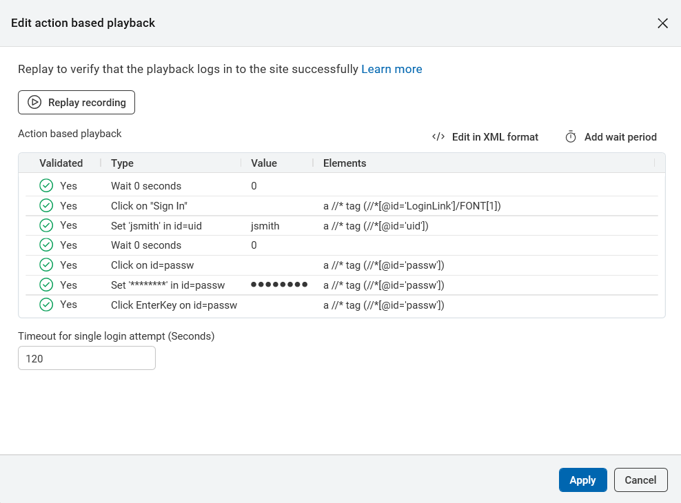

Edit action-based playback
Dialog that opens from Scan Configuration > Login Management > Advanced options > (Action-Based) Edit, can be used to troubleshoot the login procedure if validation fails.
Even if Request-Based login succeeds, it is good to troubleshoot the Action-Based Login if possible.
Figure 1. Edit action-based playback dialog box
Edit Action-Based Playback dialog box
Table 1. "Edit Action-Based Playback" settings
Item
Description
Replay recording
Replays the recorded login procedure.
Edit in XML format To view and edit in XML format. Alternatively access this option from the three-dot-menu-vertical menu
Add wait period Adds wait period at the end of the sequence.
List of requests, and wait times between requests.
Shows the following for each action:
  • Validated: Green check mark with "Yes" for actions successfully performed; red X with "No" for unsuccessful actions
  • Type: Description of the action (such as "wait", "click" or "set" (value)
  • Value: For wait actions: time in seconds; for user actions: name of the action
  • Element: HTML element on which the action is performed
three-dot-menu-vertical > Add a wait period before selected item Adds wait time before the selected request.
three-dot-menu-vertical > Add a wait period after the selected item Adds wait time after the selected request.
three-dot-menu-vertical > Edit Edit the value of the request to modify only the selected item, except for wait actions. To edit all wait actions at once, sort the table by the Type column, select the wait actions, and then apply the changes.
three-dot-menu-vertical > Delete Deletes the selected request in the sequence.
Timeout for single login attempt (seconds)
If your login procedure needs more time you can increase this setting.
